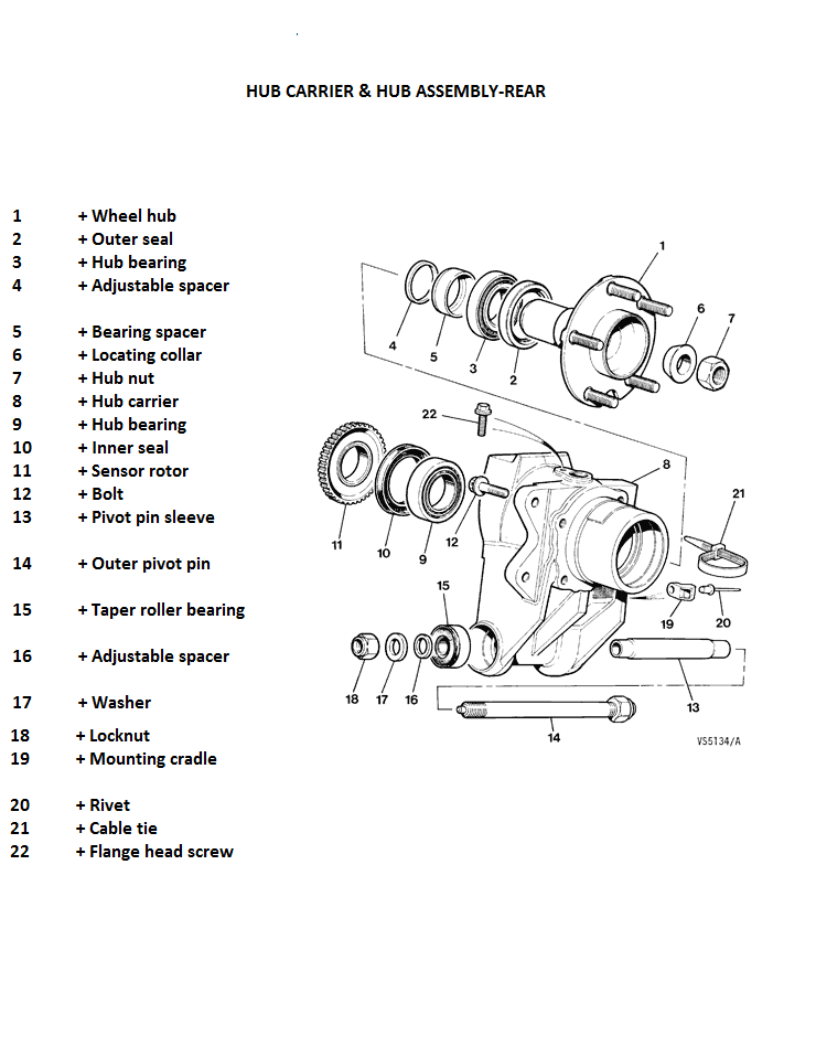

I have had also such a "metallic" noise from the rear axle and it turned out, that the pinion between hub carrier and control arm lost all his grease.
So the taper roller bearings corroded badly. It was easy to determine, because there was a remarkable play between controll arm and hub carrier.
After replacing the roller bearings (Part # CAC4610) and the pivot pin sleeve (MNE4520AA) everything was silent again.
I hope that this may help you.

My "knock" odyssey was the tapered bearing #15.

Yes, it could be also heared, when pushing down the trunk, but it was more distinct, when driving slowly over an edge. For example, when driving rearwards out of my garage, the rear wheels pass an edge of 1 inch height. This was always accompanied by a knocking sound.
@ King Charles: the replacement of the tapered bearing was also the remedy in my case.
