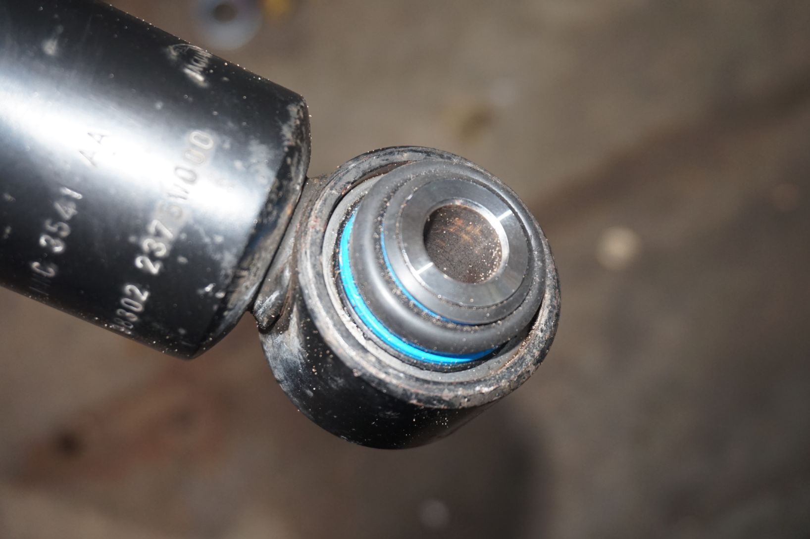

I have here a few pix for clarification:
These were the lower rear bushes, which I replaced - yes, those in the shocks. The old ones really had it, as you can see.
That's those bushes after replacement with new ones, using a hydraulic press.

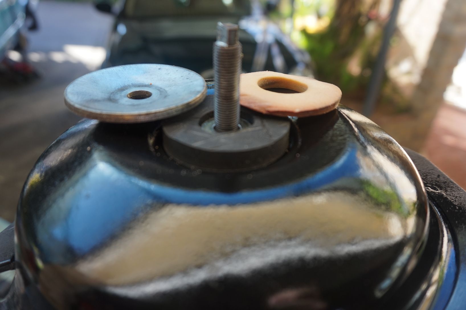

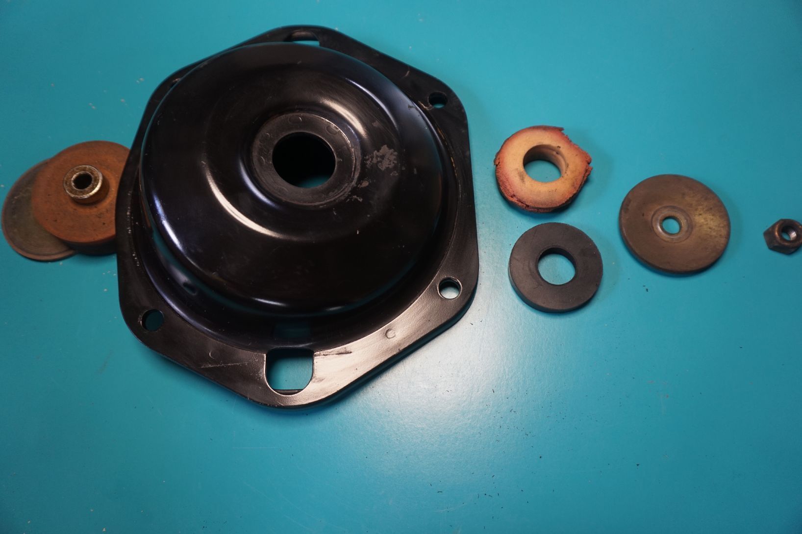

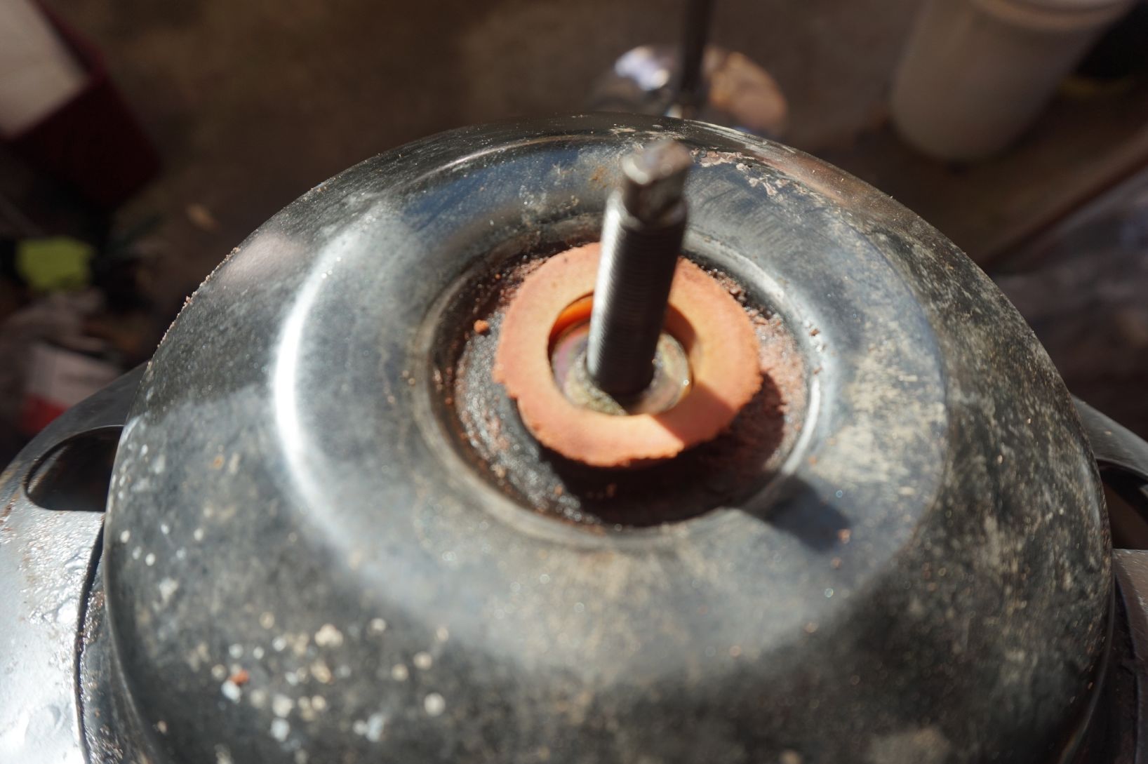

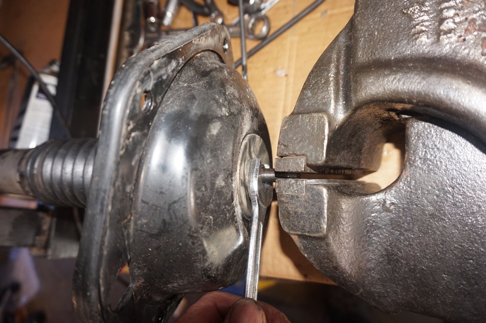

And back then, while I was on it, I also took care of the sad looking upper section of the shocks - that is what Bob (motorcarman) was mentioning the isolators.
But instead of buying a whole lot of expensive isolators, I looked at what is really damaged - and it was basically just the orange little "sponge" in the picture above.
I found that I just had to buy some cheap generic rubber parts (that black one). The parts I got had double the thickness, hence I just cut one into halves.
"For good measure' I even reused the utterly damaged orange "sponge" seen above, after grinding it off and placing it on top of the new black rubber parts. I reckon that is better than original...
