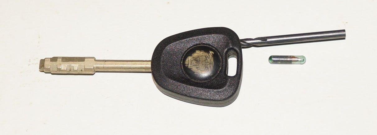

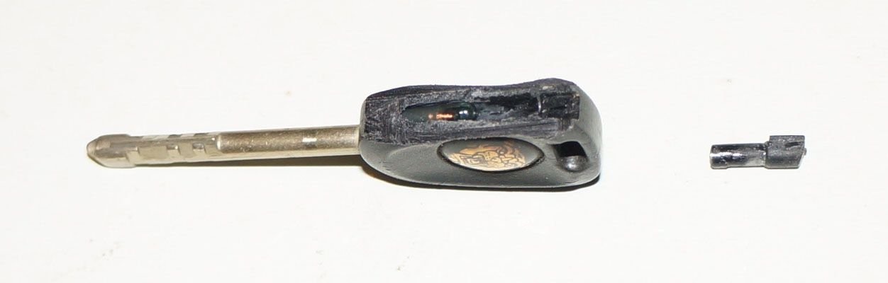

Just finished moving of the chip from the used key to my new "chipless" key.
The new key (JLM1950) has the same plastic plug at the top of its head as the chipped keys except that there is no chip inside, just empty space. I drilled a 1.2 mm hole through the centre of the plug and screwed-in a suitable self tapping screw but the plug would not move (glued) even with quite a bit of pulling force. Then I just drilled through the plug with a 3.2 mm drill bit as the chip has 3.06 mm diameter (and is 13.5 mm ling). The total depth of the hole in the key head is 27 mm and the plug is 13 mm long. So, I drilled down for 13 mm and the drill bit entered the chip cavity.
As you can see on the pic, the angle of the chip hole (and the angle of drilling) is not parallel with the key shank but about parallel with the side of the plastic head. I new this by looking at the hole that I exposed by cutting the head of the used key. Care should be taken not do allow the drill bit to go deeper than 1" as it may deepen the chip cavity or even come out at the other side. Also found a suitable plastic plug to neatly plug the hole after chip insertion.
This is how I removed the chip from the used key (once I split the head apart, I cold prize the plastic plug out):
Well, this what you can do if you, like me, buy the wrong key blank. The positive side is that JLM1950 is about half the price of a chipped key blank HNA7230AA1.
Now just to do the key module re-programming to include this beautiful new key.
