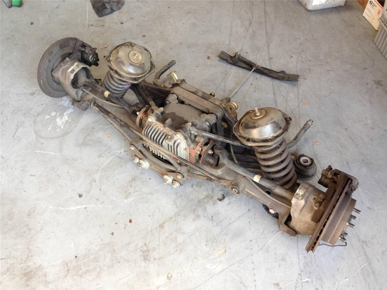

Although I have not replaced anything in my very same X300 suspension I think of it in terms of depth levels
A / shocks and shock bushings
B / A arms and roll bar bushings
C / Vee mounts , requires engine upper cradle , unless someone knows an easier / cheaper way
This A , B , C can have items added by viewer's experiences in while there groupings
In your case a target item of a suspected Vee mount makes you map out your attack
Certainly welcome others that have the experience in this area to expand on this approach
This is someone great pic of a like X300 with the green disk the engine block attach
The upper shock attach on the X308 I believe has the same needed 4 donut isolators
You will need the lower shock bolt bushing as you may see daylight through yours ( there are cheap low service life replacements to avoid ) Hi Bob
Jaguar part # ?
Steering And Suspension | Jaguar Land Rover Classic Parts
I'm I looking at this correctly for the X308 as Item # 13 lower shock bolt Motorcarman ? This is starter information for original poster
Xj 1998 - 2003 (from 812317 To F59525) (x308) Classic / Wishbone-front-upper And Lower | Jaguar Land Rover Classic Parts
