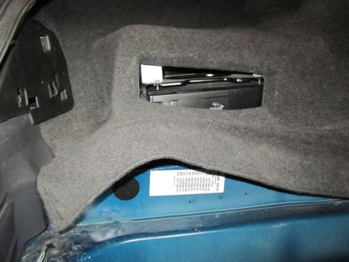

Hi
You need to look at VCATS list located in the trunk (boot) compartment.
Remove the boot floor covering, then the spare tire and finally pull the boot side liner (driver side) out enough (the bottom) to view the VCATS list.
Here are photos of I took inside the boot of our 2001 XJ8:
This shows the location of the VCATS list
Here is blowup of the VCATS list show in above photo
See the SLM in VCATS list - LNG2600HB/008 - the 008 is the software revision (s/w version number).
Jim Lombardi

Guys:
coastal has the VCATS off his old module. He wants to know what will happen if he substitutes a different one.
coastal:
I think you can get the picture that it is unlikely anyone will recommend a substitution for any module. And there is just not a good source of information about what is different in each.
