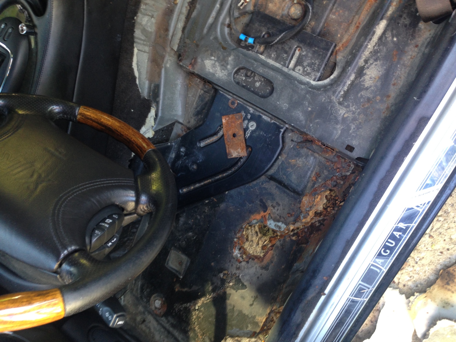

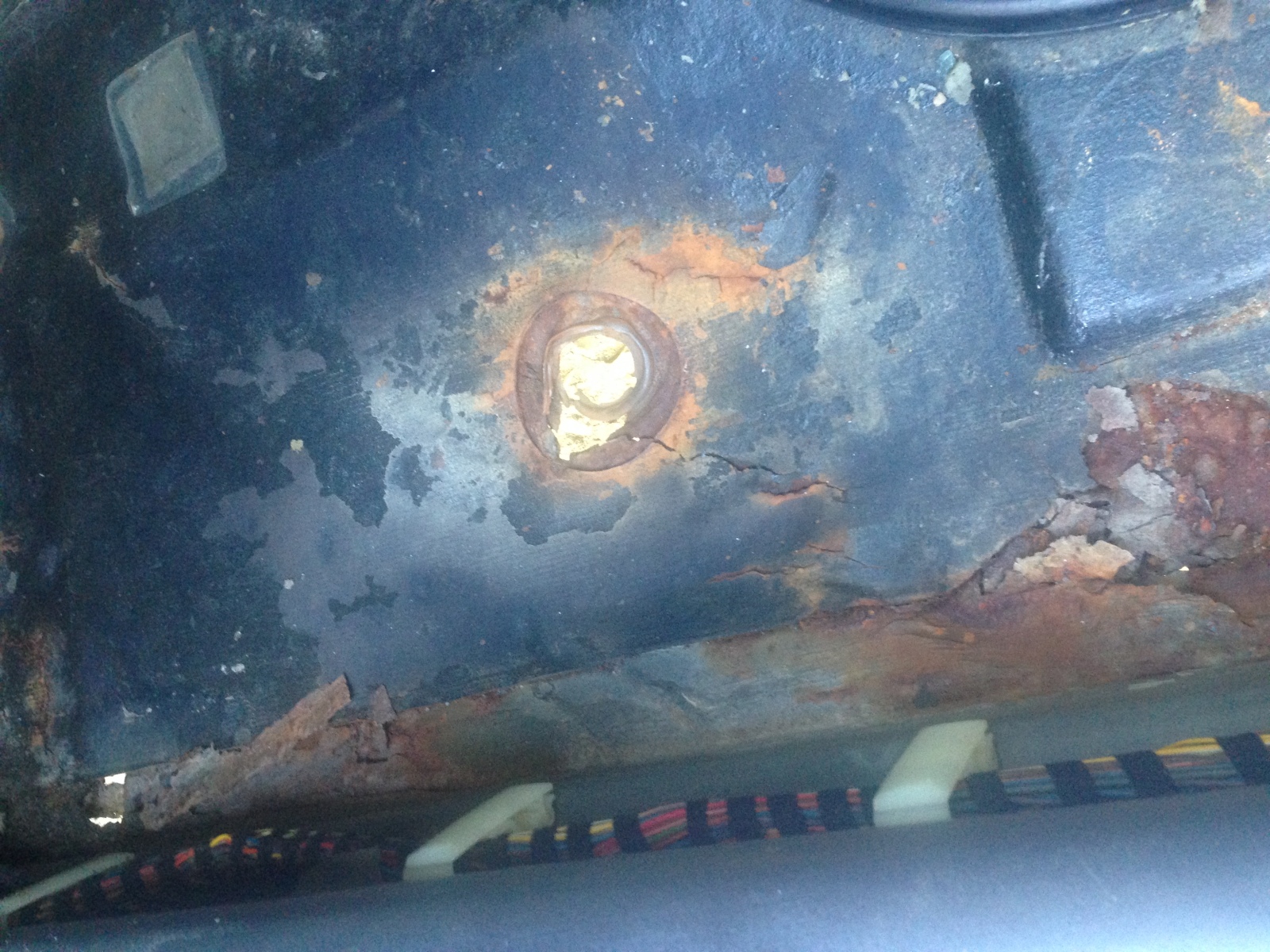

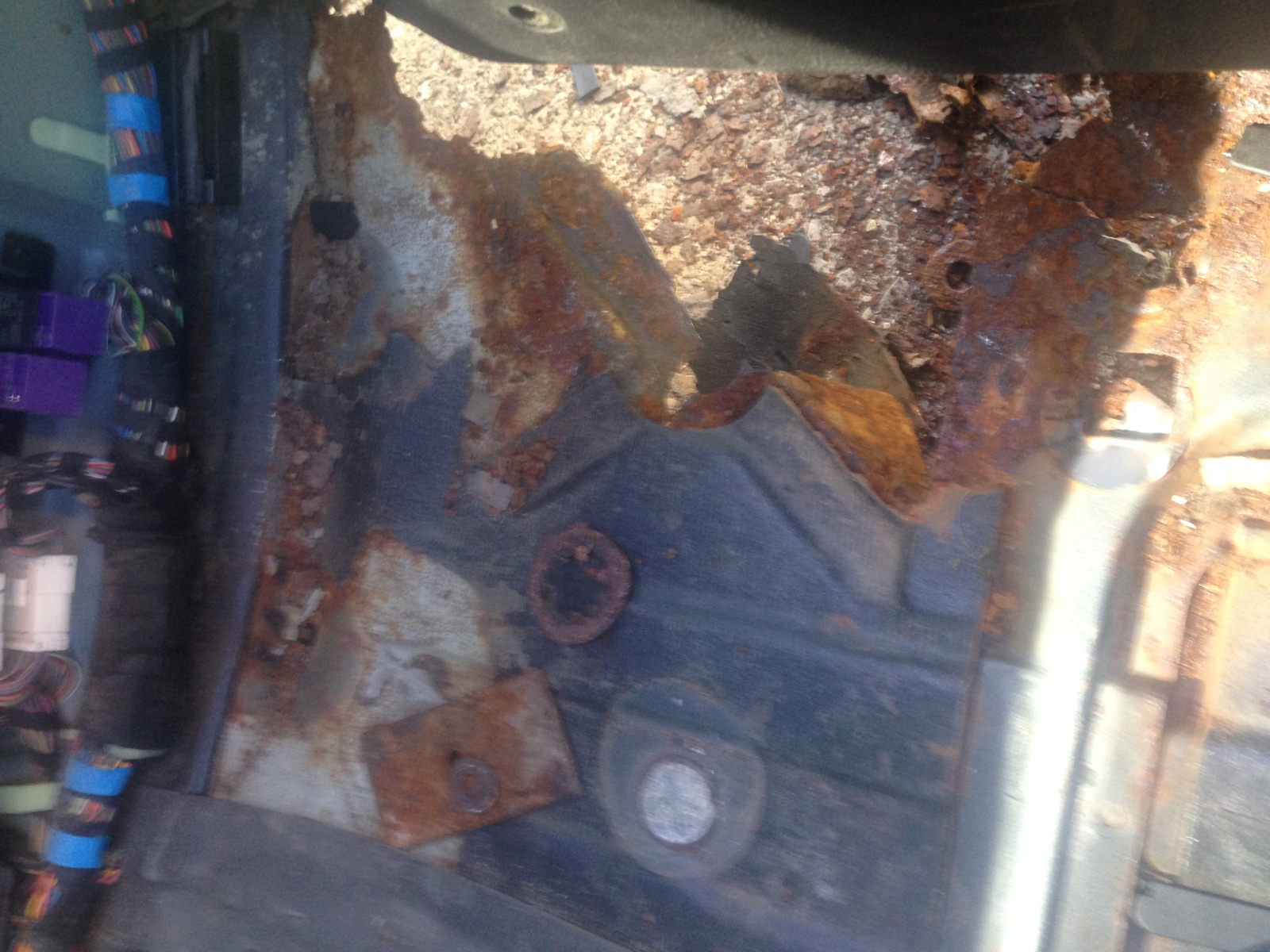

Rust! Lots and lots of rust and holes in the floorboard.. I would have never purchased this car if I knew the rust was going to be this bad.. But now that I'm here, I might as well go ahead and fix it.
I plan on welding in some new sheet metal, installing new padding and carpet, then fiberglass for the undercarriage.
Does anyone have any recommendations?
Also, I need help with a few things if you don't mind?

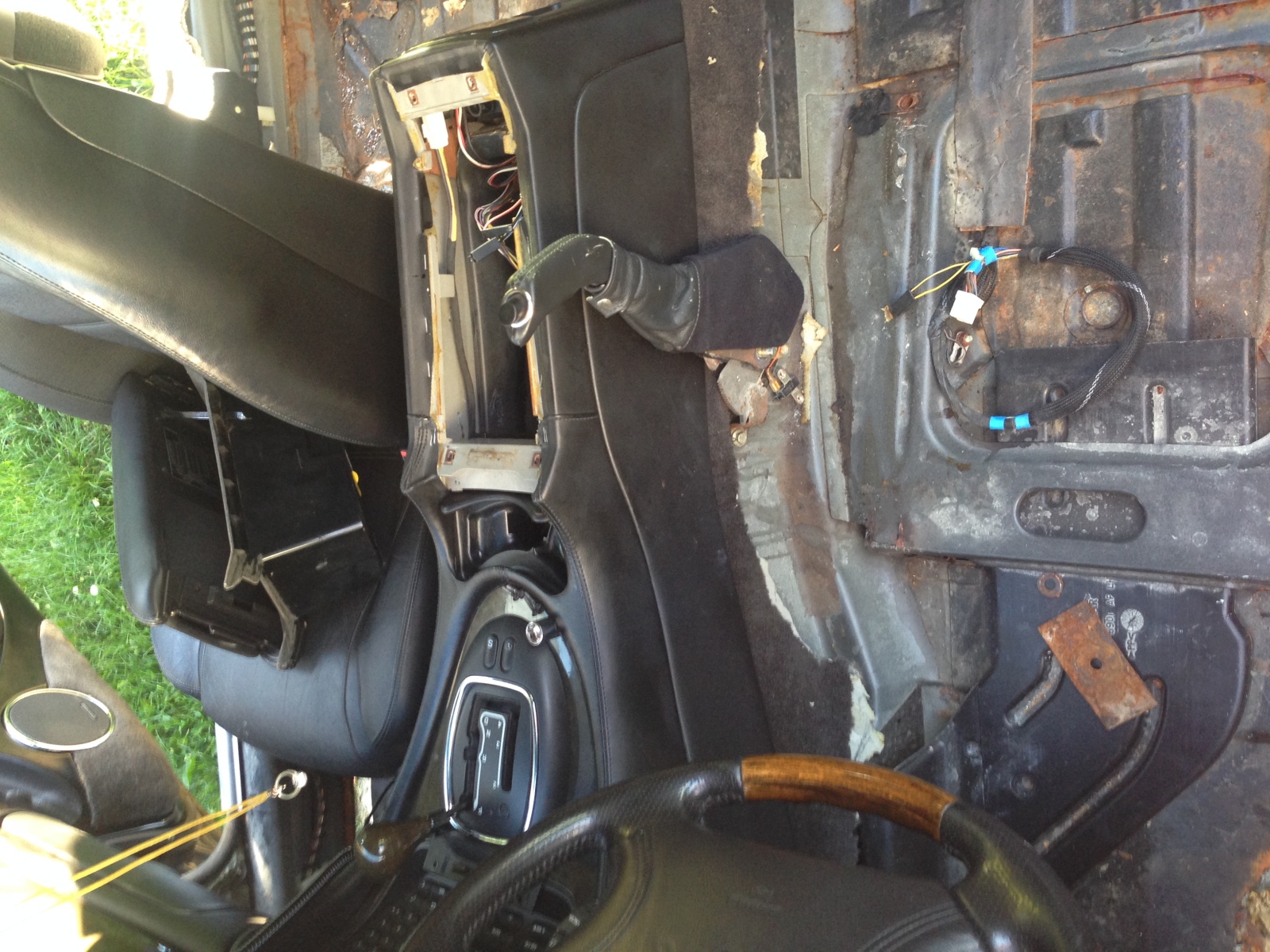

1) Need to know how to get the center console out (to install new carpet)
2) How do I remove the metal panels on the door seal?
Thanks guys! Always appreciated!

Might want to consider getting a donor car. Once the engine or Transmission fails these cars go for under $1,000. You would end up with a rust free car and a lot of spare parts.
When the engine died on my XJ8, the most I was offered was $300 for the car.

Lavaman
Here are the instructions & illustrations on removing the floor console in JTIS manual:
Floor Console PDF file
https://www.dropbox.com/s/1wfg041q31...le%20R%26I.pdf
Floor Console Extension PDF file
https://www.dropbox.com/s/ner6jjyzfv...on%20R%26R.pdf
Floor Console Finish Panel Bracket
https://www.dropbox.com/s/9s8n9y4n45...2076.25.26.pdf
Floor Console Ashtray
https://www.dropbox.com/s/7qrg6urfdt...2076.25.25.pdf
Floor Console Stowage Compartment
https://www.dropbox.com/s/9gqsed107s...2076.25.16.pdf
https://www.dropbox.com/s/b0gsja74j3...el%20R%26I.pdf
Here is the front door weather seal information:
https://www.dropbox.com/s/besyrti8xu...ip%20R%26I.pdf

Yeah! It was pretty bad.. About 85% of the rust is now gone, and new sheet metal was welded in.
90,000 miles and it was spent in KY most of its life. Wrecked, totaled, and literally just sat for years.

Sheet metal - $50 or so
Spot weld by me - Free
Quicksteel - $150
I began by cutting out the old rust with a saw, then measuring, sawing and bending new sheet metal to fit perfectly over the holes. After that I spot-welded the sheet metal, applied quicksteel to seal it thoroughly, then sprayed the undercarriage with rustoleum, and finally applied bondo/fiberglass to seal the undercarriage.

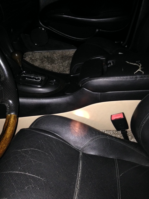

So here are a few pictures of the interior so far.
What's new or changed:
-New sheet metal on floorboard.
-New padding.
-New carpet (plush, house carpet)
-Marine vinyl headliner, trim and handles.
-Center console wrapped in two-tone black leather/camel marine vinyl.
-Hand-stitched sun visors camel/black piping. (Getting better at sewing.. lol)
I still have a few additional mod ideas for the interior.. But this is what I've completed so far.
The marine vinyl is some great stuff! And I love driving with no shoes
