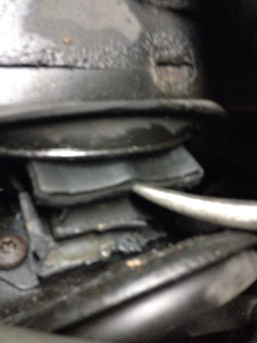

I while ago had a movement clunk under hard or pumping braking from the
front subframe ,just like the whole thing would come lose ....
I Replaced the :
1 Front subframe V mounts ,the rubber that was gone and the subframe was
loose in the mount ,glad it has sort of build in safety brackets..
2 Front subframe round mounts ,on the rear they were weared..
3 The 2 front motor/engine mounts ,showed pics before they were in 2 pieces ,maybe because al of the movement /play from the subframe
4 The rear gearbox mount that was broken also ,the rubber was loose
Thougth the problem was over ,but just now...under hard breaking
I heard a hard clunck ,it was just like the subframe came loose again
The movement off the frame and engine BROKE the hose connector to the power steering fluid bottle ,and the power assistent failed {PIC} ....also the REDUCED POWER light came on, in the dash .
Is this normal when you loose your power assistent?
I will order a new steering fluid bottle tomorrow and that d... fluid thats all over my engine bay......
And i wil check the V MOUNTS ..what broke or failed AGAIN..
Attached Thumbnails Subframe V mount broke again??-10374028_633636883371231_8067934464127985369_n.jpg

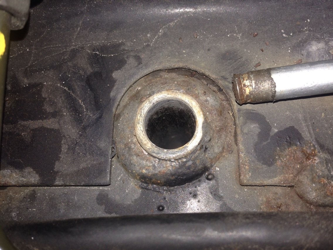

Attached Thumbnails Subframe V mount broke again??-971439_515624825172438_684903876_n.jpg   Subframe V mount broke again??-1239459_515624928505761_994996296_n.jpg
Old 06-04-2014, 09:36 AM
DJ-Roy's Avatar
Join Date: Feb 2012
Location: Amsterdam The Netherlands
Posts: 211
Received 28 Likes on 19 Posts
Just fixed the Reduced Performance warning .
The MAF connector was also loose because of the movement of the engine/subframe.
Cant see what happend with the subframe or mounts yet {a broken bolt or torn mounts ?}..
i first have to replace the broken power steering fluid bottle ,so hopefully i have the power steering again ..

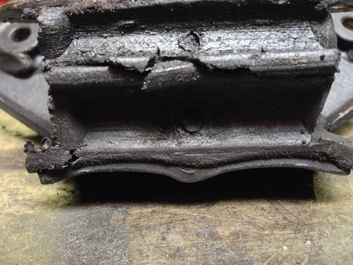

Old 06-05-2014, 04:15 PM
DJ-Roy's Avatar
Join Date: Feb 2012
Posts: 211

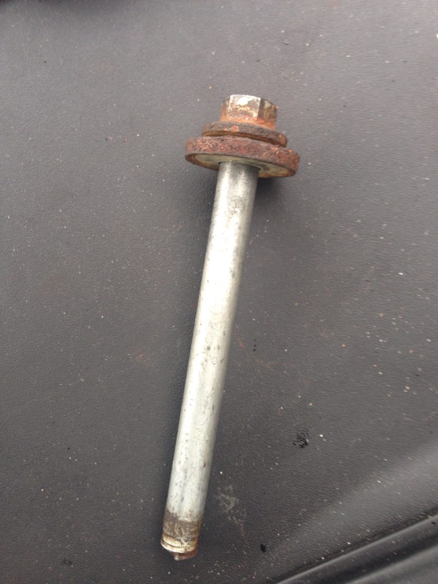

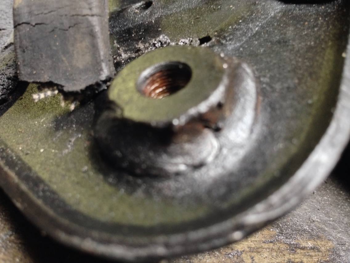

Already took one subframe bolt out by hand ,have to check what more broke ...
Attached Thumbnails Subframe V mount broke again??-10296296_634435223291397_8123984284571604065_o.jpg   Subframe V mount broke again??-10387039_634434973291422_1767119539948121700_o.jpg
Old 06-05-2014, 05:25 PM
plums's Avatar
Join Date: Feb 2011
Location: on-the-edge
Posts: 9,733
Received 2,166 Likes on 1,610 Posts
Maybe they were overtightened. The specification is surprisingly low at 22-28 NM.
Then again, like many load bearing fasteners on these cars it is smaller in diameter than what some people are accustomed to.
DJ-Roy (06-06-2014)

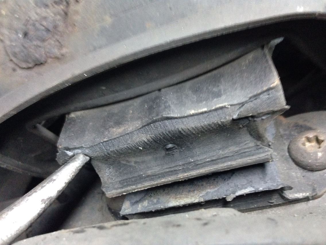

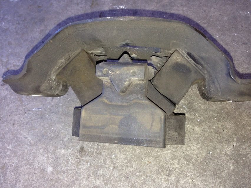

Old 06-10-2014, 10:10 AM
DJ-Roy's Avatar
Join Date: Feb 2012
Posts: 211
BOTH THEM NEW {3 months under the car } V MOUNTS >>>THE ATTACHED RUBBER CAME LOOSE FROM THE METAL
{sorry for shouting but new parts that fail....and its a dangerous situation}
i ordered 2 new price 243,00 USD at the J dealership today..
The other broken set i bought from ebay 123 UK pounds hope its original advert says Jaguar part......asked the seller for warrenty hope he helps..
BTW If i weld them mount solid with metal iso rubber would the car still handle ??
Attached Thumbnails Subframe V mount broke again??-10293792_636704086397844_4977987285605676340_o.jpg   Subframe V mount broke again??-10467095_636703563064563_3511185087095394645_o.jpg   Subframe V mount broke again??-10296120_636703556397897_2209956958582645821_o.jpg   Subframe V mount broke again??-10454499_636703889731197_7391020499133707494_o.jpg
Old 06-10-2014, 05:59 PM
Sean B's Avatar
Join Date: Oct 2008
Location: Sunny Southport UK
Posts: 4,757
Received 1,341 Likes on 1,057 Posts
Just replace with genuine parts. The car deserves it, you know the score Roy.
Plums has given the torque spec' and by the look of it they where over-tightened by some way. Get new Jaguar bolts too.
Old 06-10-2014, 07:40 PM
DJ-Roy's Avatar
Join Date: Feb 2012
Posts: 211
I know Sean ,learned my lesson with that ...,i already got 4 new bolts and washers .
Just asked the Ebay seller to conform its was a Original V mount ,because i never buy trash aftermarket parts anymore.
At the time Jaguar had them in backorder ,so i ordered them from Ebay
The advert says : Manufacturer:Jaguar PART NUMBER: MNC2360AB
my thoughts it was original
When i take them of the car thursday i can inspect them better ,next to the new ones from the dealer..

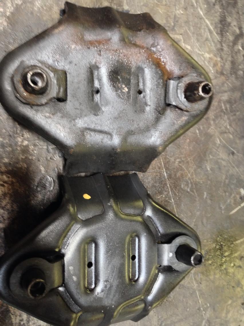

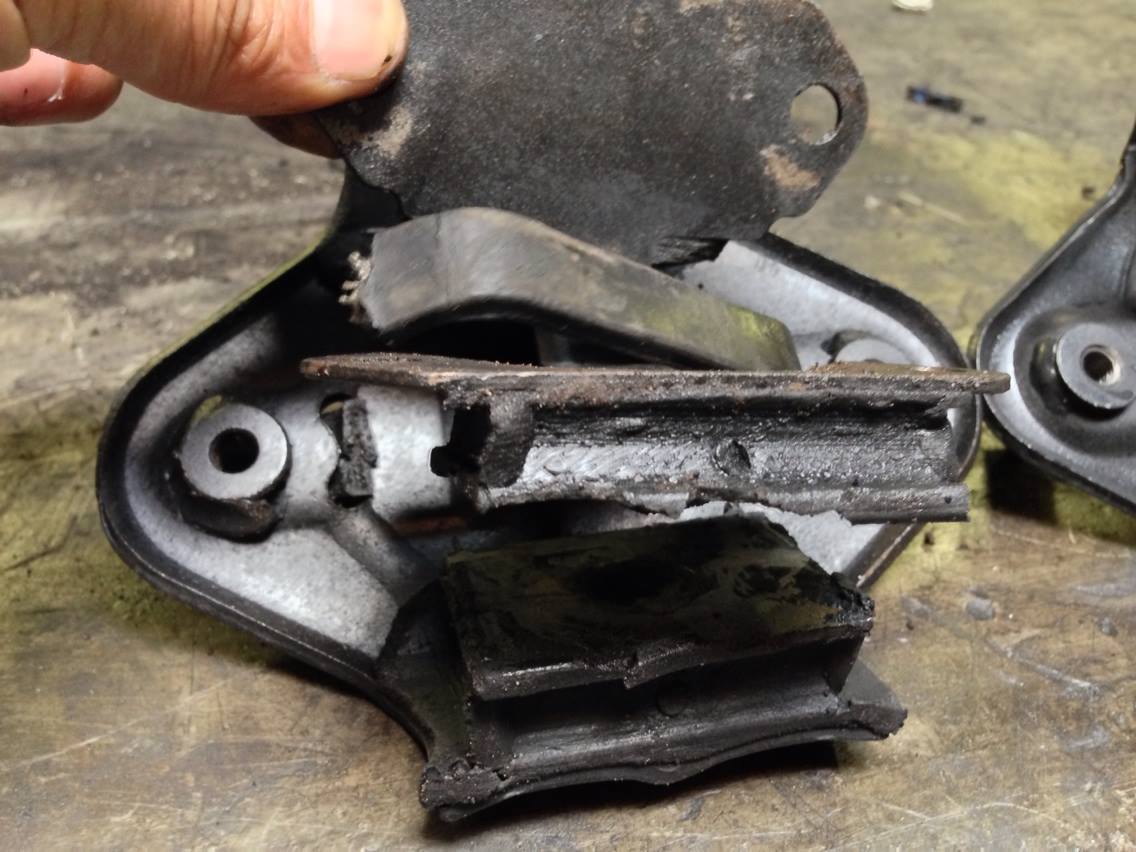

Old 06-13-2014, 07:44 AM
DJ-Roy's Avatar
Join Date: Feb 2012
Posts: 211
Yesterday got the subframe V mounts from the Jaguar specialist
They put the new original V mount on ,i have made pics to compare them
First picture is scary the belt safety holders/brackets also broke ....
I got a reply from the Ebay Jaguar seller ,i have to send the broken
V mounts back to the UK and his supplier will check them out for a refund....
The ad says Manufacturer JAGUAR......with original part number
I have more damage caused by this inferior part ,i feel a bit misled by the Ebay ad but i will send them back
To the seller hope they will not sell them anymore, i think this part is not safe.
What wil happen if you brake at very high speed when the front subframe comes loose?......
Attached Thumbnails Subframe V mount broke again??-10286801_638069056261347_6988110620089217335_o.jpg   Subframe V mount broke again??-10365541_638070952927824_6338272674966273599_o.jpg   Subframe V mount broke again??-10295467_638069202927999_1187015241940557816_o.jpg   Subframe V mount broke again??-1556369_638069049594681_8338350954609465278_o.jpg   Subframe V mount broke again??-10383830_638069216261331_6831274417200976980_o.jpg
Subframe V mount broke again??-10465495_638069209594665_474331459111690429_o.jpg   Subframe V mount broke again??-10355620_638069212927998_7479260272208879280_o.jpg   Subframe V mount broke again??-10365541_638069039594682_3087255683977606089_o.jpg
Old 06-17-2014, 05:41 AM
DJ-Roy's Avatar
Join Date: Feb 2012
Posts: 211
Checking these dangerous fake V subframe mounts the seller want back for inspection ,
the brand is probably IMC URO..
The price of these fake V subframe mounts is about $25/35 on Ebay
I payed $208 {50 UK pounds a per mount} on Ebay from a big Jaguar Parts
store with 100% feedback.....
I added a sales picture from the seller with the fake URO mounts
I you look closely where the mount holds the subframe the bolthead has no room left it touches the rubber ..
Attached Thumbnails Subframe V mount broke again??-%24-kgrhqf-osfbzt6-rsybqhnzjouig%7E%7E60_57.jpg
Old 06-17-2014, 06:30 AM
Badbenz94's Avatar
Join Date: Aug 2013
Location: Joliet, IL
Posts: 360
Received 41 Likes on 35 Posts
Wow the difference in quality is eye opening. I'm so glad I bought OE Jaguar mounts. One of the business mentioned on this site before tried to sell me the after market URO saying it was the same as Jag. I don't think so...
Thank you for the pics. Hope things are smooth sailing now.
Chris
DJ-Roy (06-17-2014)
Old 07-26-2014, 10:08 PM
DJ-Roy's Avatar
Join Date: Feb 2012
Posts: 211
Just to confirm ,the ebay seller has refunded the broken subframe V mounts.
The quality of these aftermarket V mounts is very bad .
It can be life threatening when the front comes loose under hard braking.
Plz only buy the original subframe V mounts at the dealer or suplier..

Before Lowering the subframe there are important things to do first ,
Or you end up with al the problems my broken mounts caused to the car .
My mechanic did the job twice to change them ,on a two post car lift.
Everything that is attached to the body and subframe/engine with Minimal play will snap or break when lowering the frame also the mount bolts are difficult to get at.
Maf sensor plug take it off ,power steering fluid bottle take it of ..
And probably more because i now have a fuel smell sometimes and Restricted performance light ,hard hasitated shifts and no power a few times after the subframe mount broke ..
Maybe a intake leak because of stress from the loose subframe ,but i have to get the codes....
Attached Thumbnails Subframe V mount broke again??-10570440_658649590869960_1810207905252533163_n.jpg

A lot those URO rubber parts come from India -- and they are junk. Lots of problems with them on the MB boards.
Same thing with seals on other parts.
On critical parts I'm an OE guy.
