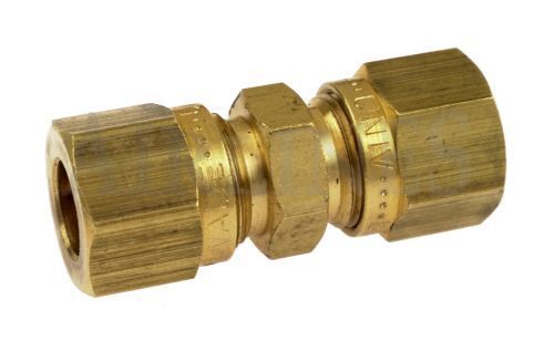

I was thinking instead of hose clamps,
I could use a straight compression fitting instead?
I think I saw they are good for up to around 400psi

...I could use a straight compression fitting instead?
Yes, that would be very good. The diameter of the aluminium pipe is probably metric. I see that this website (https://www.airlines-pneumatics.co.u...-equal/S060143), in addition to imperial, also sell metric ones but up to 12 mm (you can search for a bigger one if needed).

The pipes are 1/2" not 12mm so couldn't get a compression fitting, went with the barb fitting in the rubber hose section, worked perfectly
