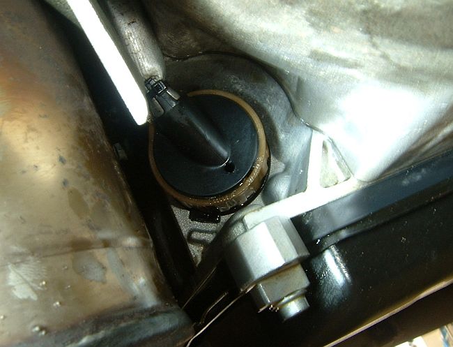

My car has oil leaking at the transmission as shown on the photo. The oil comes out after the car (and the engine) is stopped, and parking for more times. Is it a common problem for this MB trans, or not. What is the easiest way to cure it?

The plug has a inner sleeve with two o-rings and bolts to the conductor plate inside the transmission. I'm not sure if you can disconnect the plug and replace the sleeve without moving the catalytic converter. The XKR has a heat shield in the way,also, but I don't see one in your picture. The fluid must be drained from the transmission to do this.

Jaguar issued a TSB (307-10) for this fault.
I uploaded it YEARS ago to this forum.
It explains everything.

xjrsteve, it looks like you will have a fairly inexpensive repair. A new socket is available on ebay here, and I assume in Europe for just 2-3 euros.

Yes, it seems easy to fix. Thank you for you guys!
