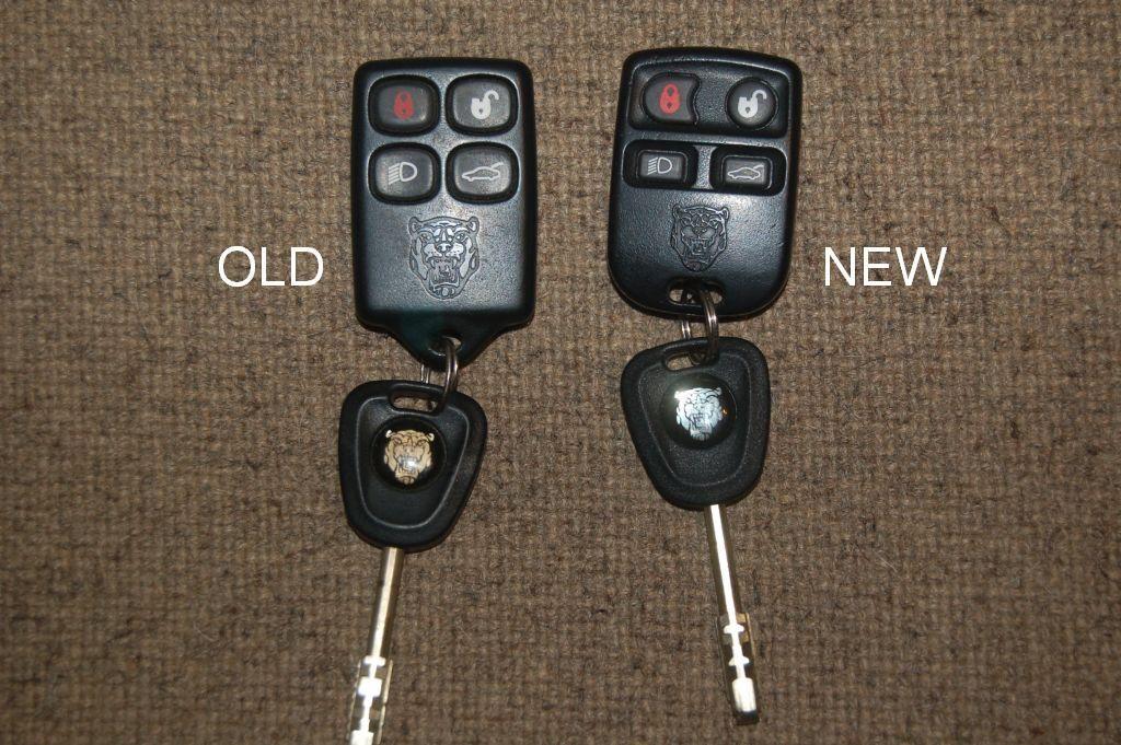

apparently x308 uses two kinds of transponders : from 97-2000 transponder 13 megamos and 2000-2003 transponder 48 megamos crypto
Old Feb 1, 2017 | 07:02 PM
ericjansen's Avatar
Joined: Dec 2013
Posts: 3,256
Likes: 1,371
From: Taiwan, R.O.C.
They look different too.
picture by Motorcarman
