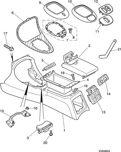

I am not sure where the build sheet location that you describe at "inside the centre console on the right-hand side".
Here is the central console parts diagram on Jaguar classic parts website:
Where do you put your hand (up at the front end of it on the right side next to the radio, or in the middle before the console storage area or ??).
I tried (with without much luck) to get my hand into the very front right side on the central console.
I sure would like to view it.
Jim Lombardi

Hello again Jim,
Roughly, just below where item No 5 is shown on diagram (that area of the centre console where it meets the carpet, vertically from the drivers footwell - or passenger footwell in Left-hand drive cars. The side of the console consists of a lower panel about 4" deep - if you put your hand behind that panel and slide it upwards you should feel the sheet of paper attached to the inside of the console (that was the case on my 2002 model - I've also got a used console in the garage from an earlier car and that also had the sheet attached). Good luck.
