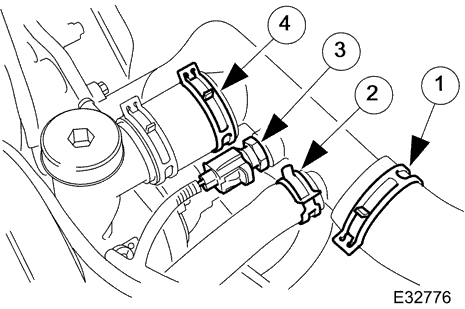

Hi Anthony
Is it the bypass hose that connects to the thermostat tower shown in this JTIS21 graphic image (see the circled 4 reference):
Part number is AJ85313 (from Jaguar Electronic Parts Catalog) retail price at your local Jaguar parts dept should be $3.15.
Jagbit website shows another part# NCA2213AC (their price is $3.80 plus shipping - probably more than the part's price).
Jim Lombardi
