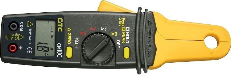

One problem I had to face when doing this kind of work and it's been mentioned above. I found it VERY difficult to keep the car asleep when making these measurements! Any small movement and the car would wake up and I would be back to waiting 45+ minutes so I could restart the test. Really got time consuming too.
So my suggestion is to NOT install the DMM in series with the battery leads. One if the car draws much amperage for any reason that's a great way to burn up your meter (Hopefully your meter is fused?). Two it's just a PIA way to do it!
I went with a clamp on ammeter so I could test for current draw without disturbing any wiring. You do need one that can measure small amounts of current and they are a bit more expensive and a bit more difficult to find. You want one that can go as low as 1 ma.
This is what I have and boy has the price increased since I purchased mine! $190!
Clamp On Ammeter Clamp On Ammeter
But there are many others at hopefully lower prices!

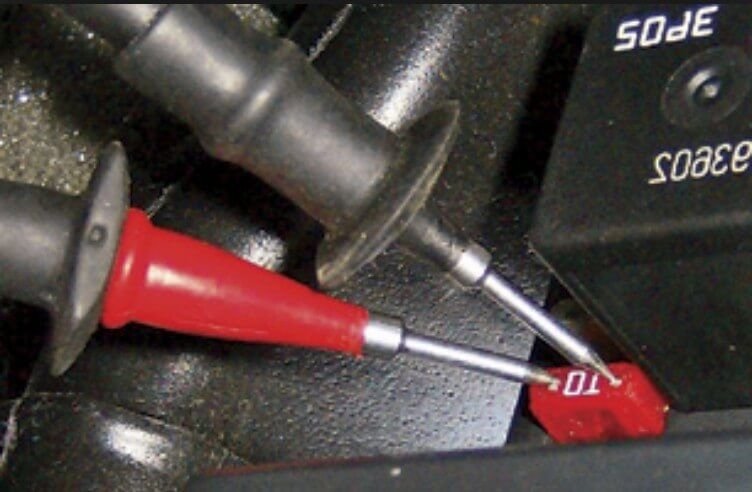

You can also troubleshoot this using voltage drop across the fuses themselves.
You will make measurements across the back of the fuse like this picture shows.
Attached is a chart so you can tell what the amperage draw is based on what voltage you read across the fuse. This is nice because again no need to disconnect anything or disturb the car. You can rapidly go thru a fuse box with this method compared to spending hours pulling fuses!
Leave the trunk open but place a towel over the latch. Depending on your car (I have a 2014 XJR) it might have the trunk close automatically after so much time. I got bit on this a few times too! But this is car dependent.
Clamp On Ammeter.
Hi clubairth1,
Where do you connect the clamp-on milliammeter and what other provisions do you make so that you can read its screen with the trunk, hood and all doors closed so the vehicle will go to sleep? It will help others to know "The Rest of the Story."
