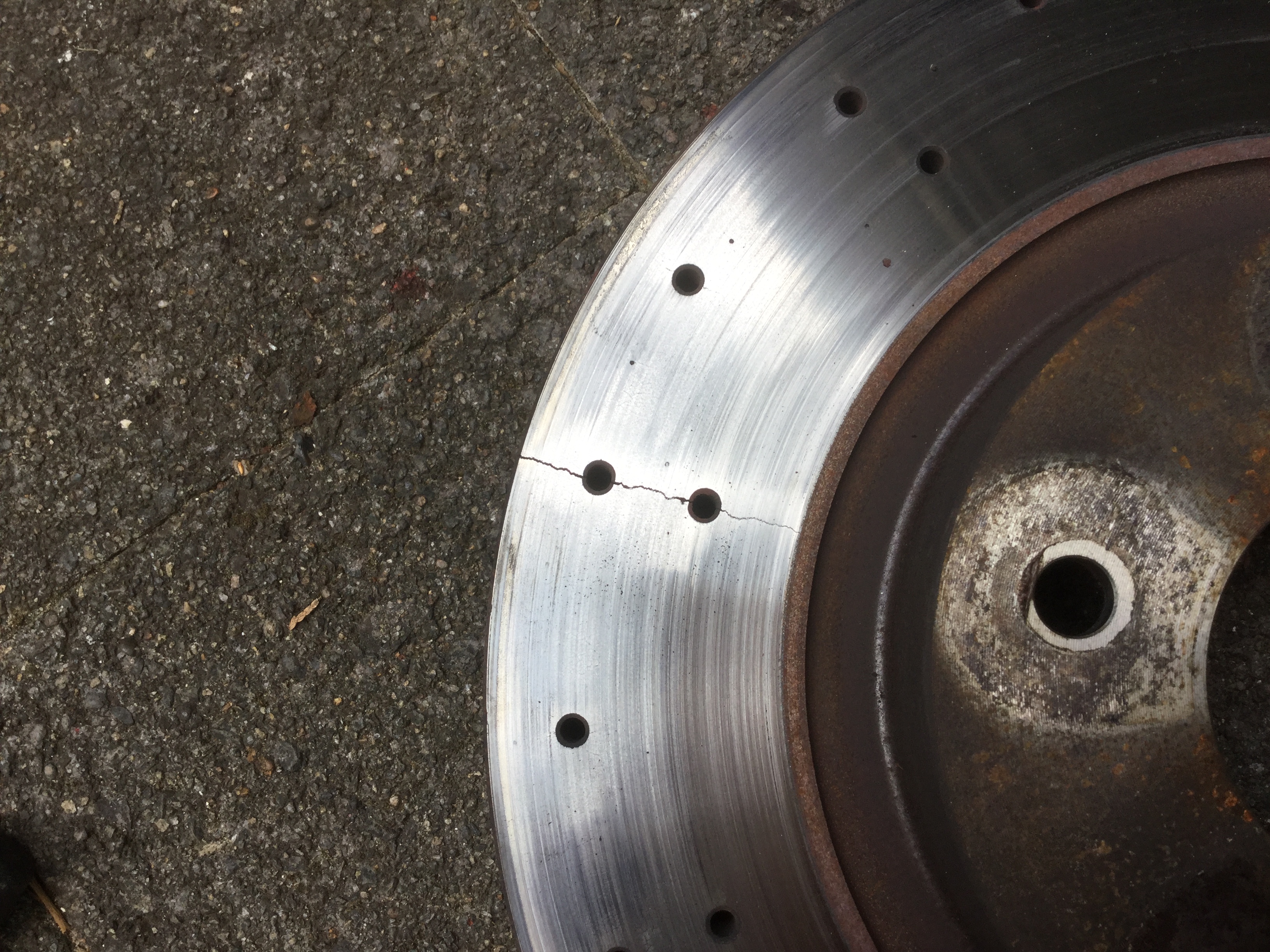

Went to take a 400klm round trip yesterday but felt something wasn’t quite correct, certainly different from a warped disc!
Odd that it happened on Sunday but wife and I were in seperate cars and she forgot to mention that something didn’t feel right
Changed them out today cleaned up the old ones for now and replaced the pads while I was in there.
What did you do to your X308 Today?-5a09bb39-4e2b-4b1a-8c8d-7ddf11e8cee4.jpeg

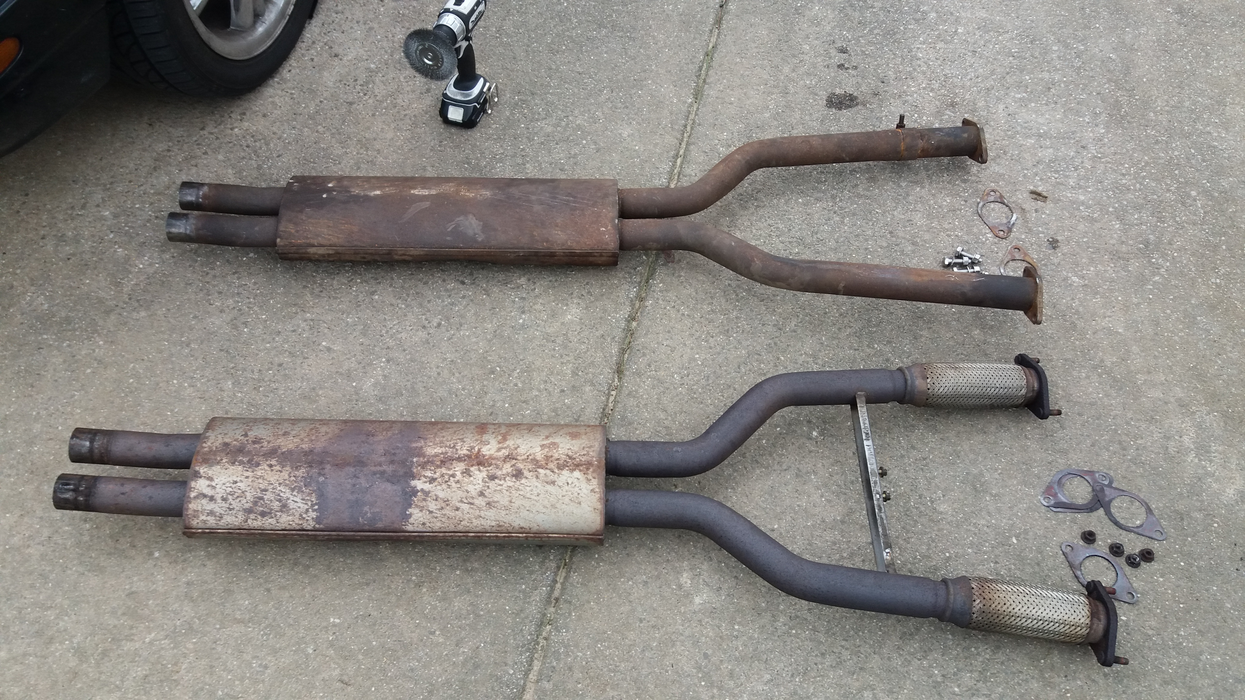

Finally replaced my front/shared muffler with the one I got from the junkyard, no flex joints on the junkyard one but it seems like it will get by without them. Reused the old cat flange gaskets and they leak with the exhaust, big surprise, but at least that's hopefully an easy replacement part to pick up from the local auto parts store. Finally fixed the damn rattle I had though, with the old muffler it sounded like the engine was about to explode itself all over the road, while now it just sounds like an old muscle car with the cat flange leak. I can live with that for now the improvement is already massively noticeable.

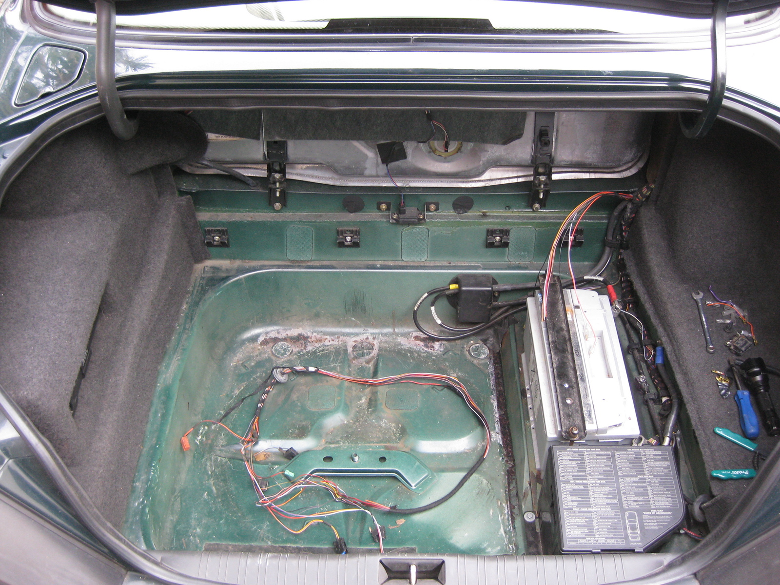

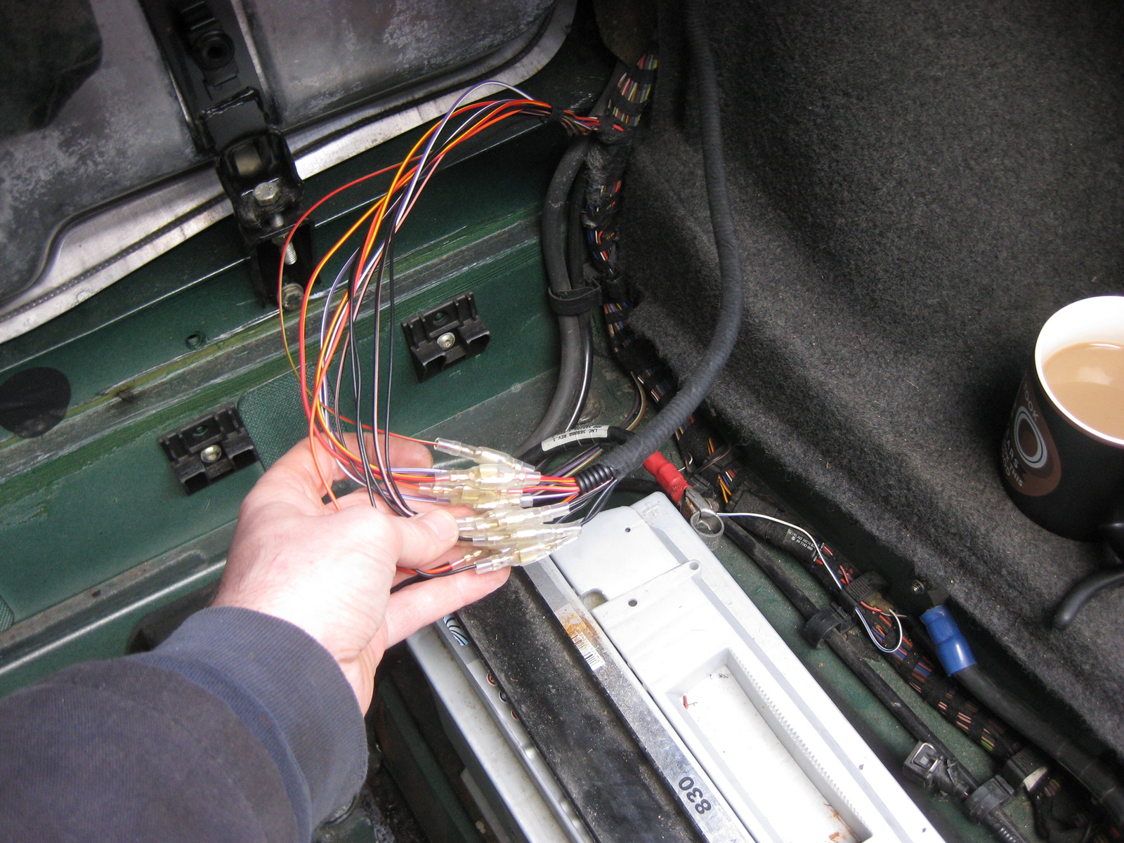

Had more electrical gremlins recently due to the boot loom getting mangled up and shorting out. Having patched it up a couple of times i decided to start fresh and replace it with a good loom salvaged from another car. As there is no plug between the boot loom and main car loom there was only one option *snip*
Bunch of spade connectors were used to attach the new loom. I also opted to keep the excess cable length in case i need to repair the loom in the future. Having the ability to cut a damaged section out and shorten it will make the job much easier.
