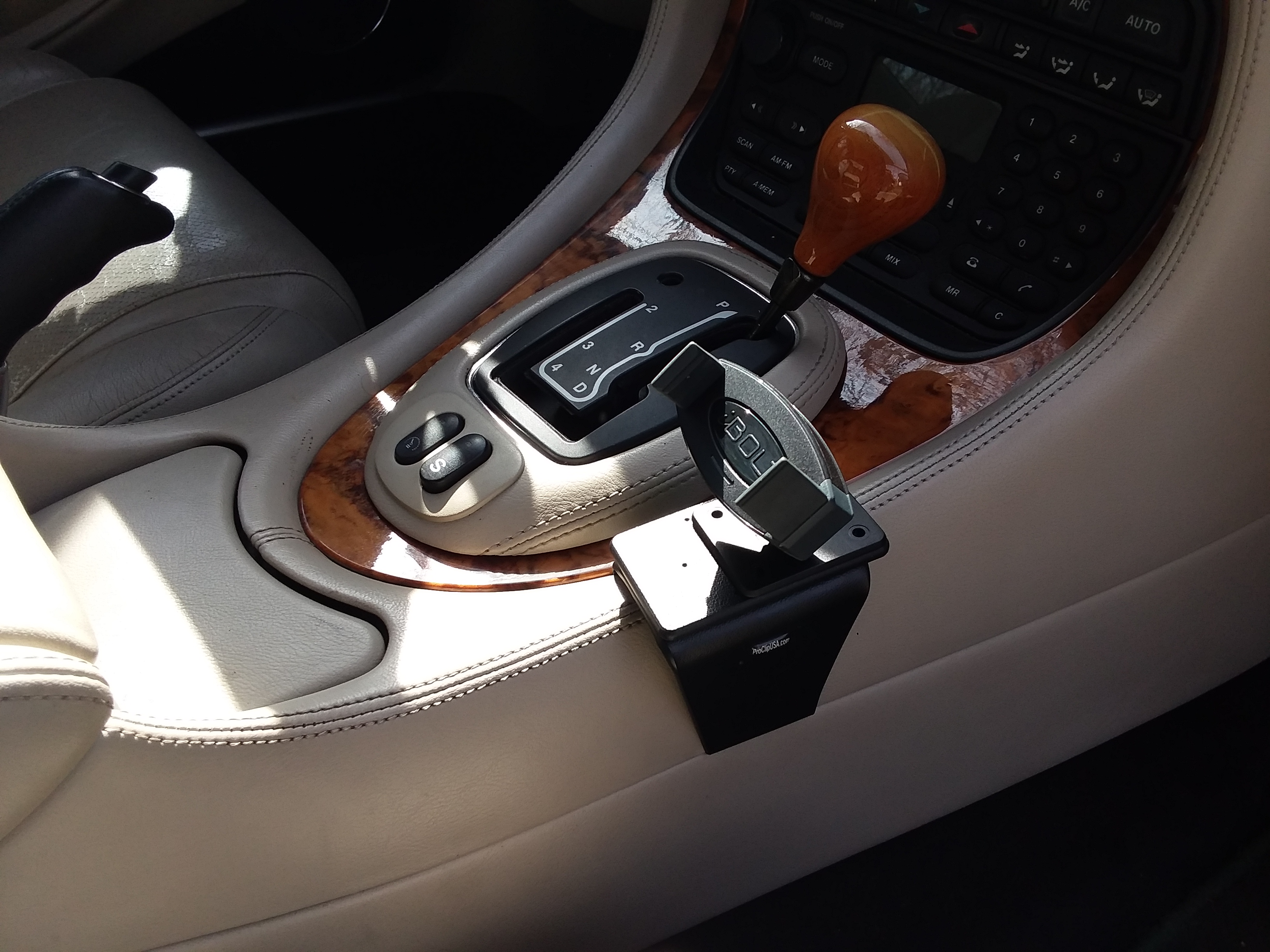

Did trunk struts and hood struts. Both made a reasonable, but not massive difference, more noticeable in the trunk. Hopefully this means I can work under the hood without fearing for a gust of wind closing it on me, or worse on some sharp tools that punch through the metal. It's definitely stiffer than it was before (and opens a bit higher) but it's still pretty broad and weighty.
Also my Proclip base finally arrived! Adhesive patched a cheap universal phone holder onto it since there's not a special mount for my phone. Very happy with the Proclip base, not so much with the holder itself but I'll get a custom holder once I get a nicer phone, no sense in splurging on a holder that I'd switch out soon anyway. See attached pic for a view of the setup from the passenger's side.

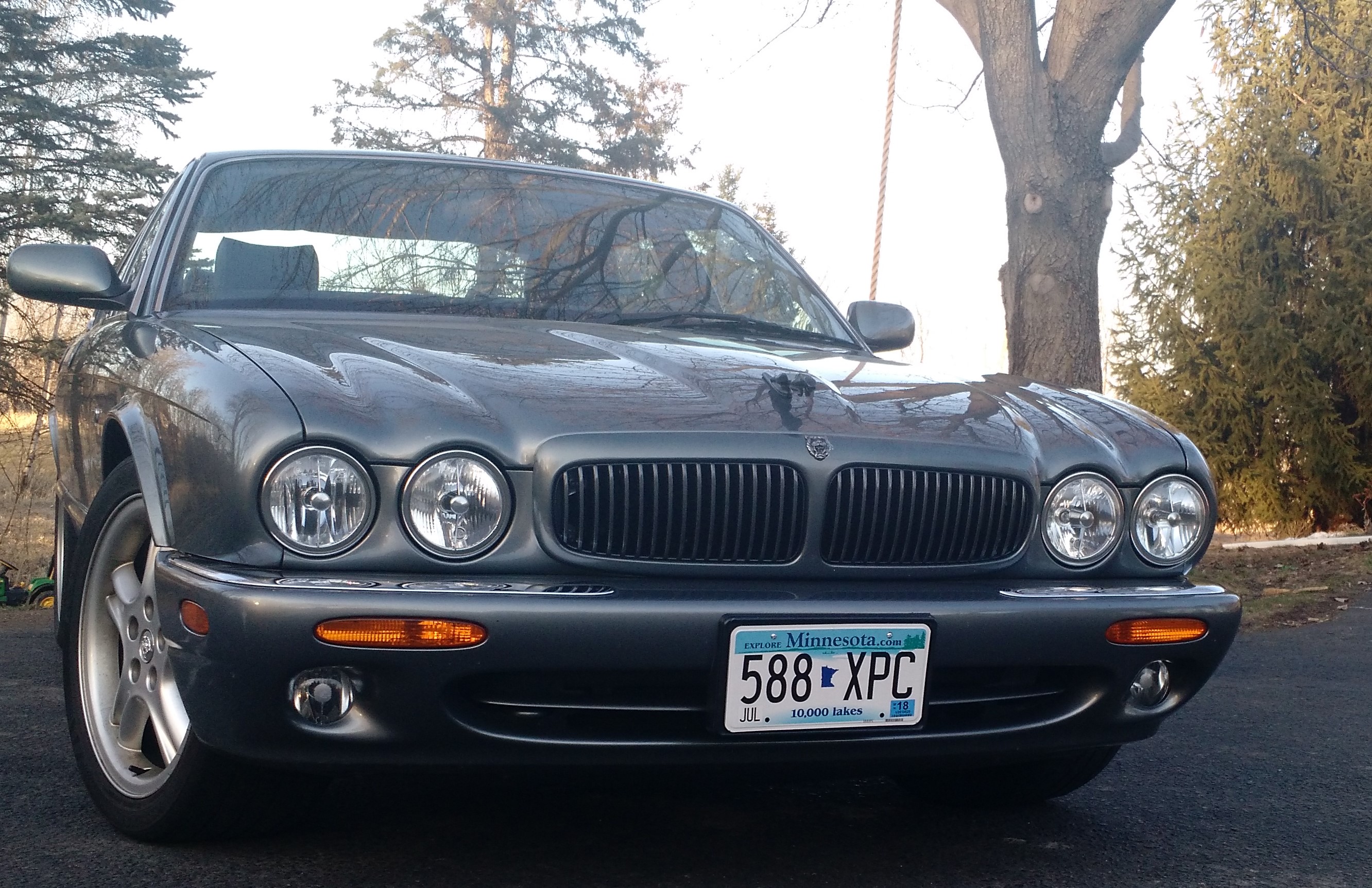

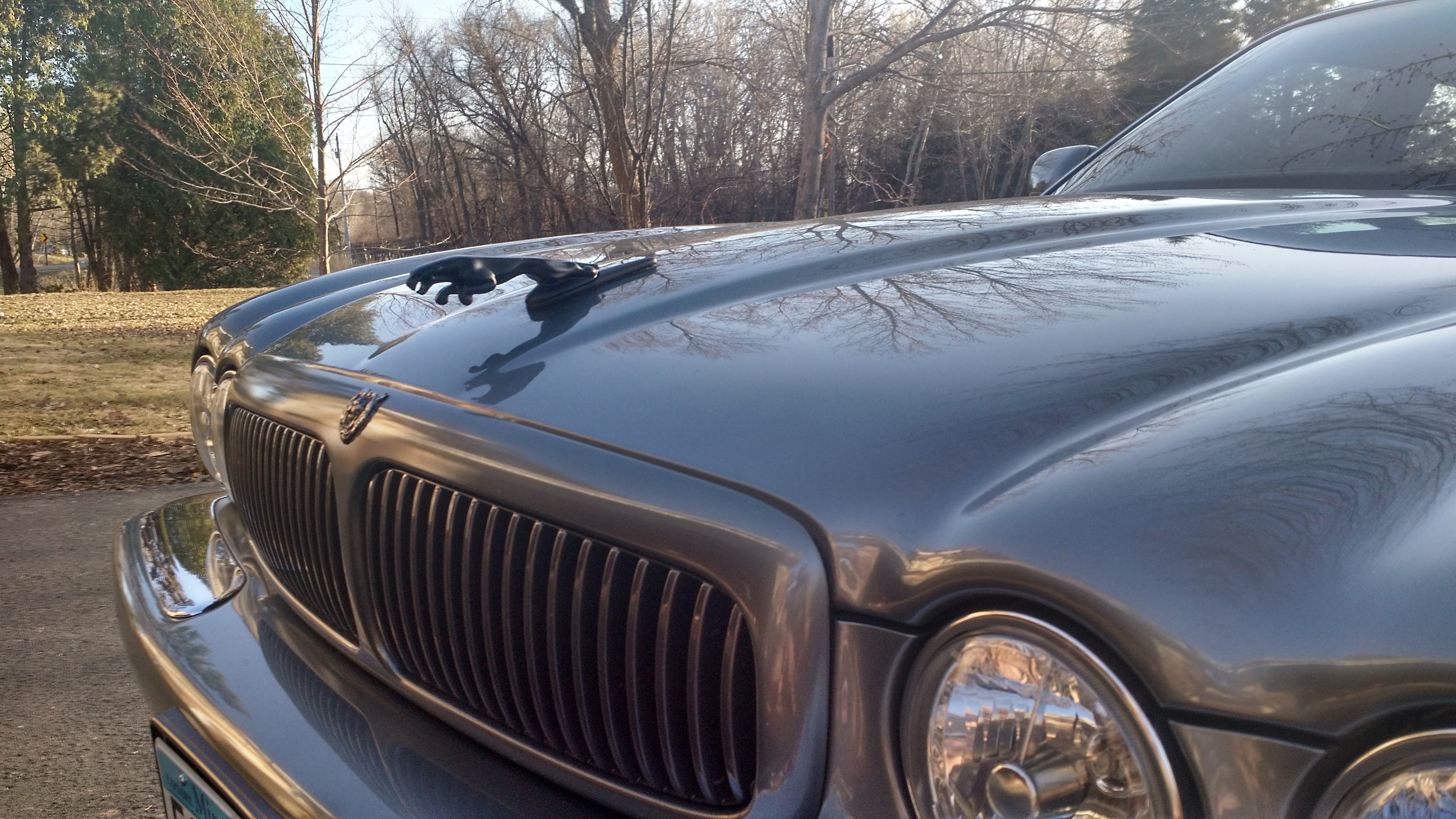

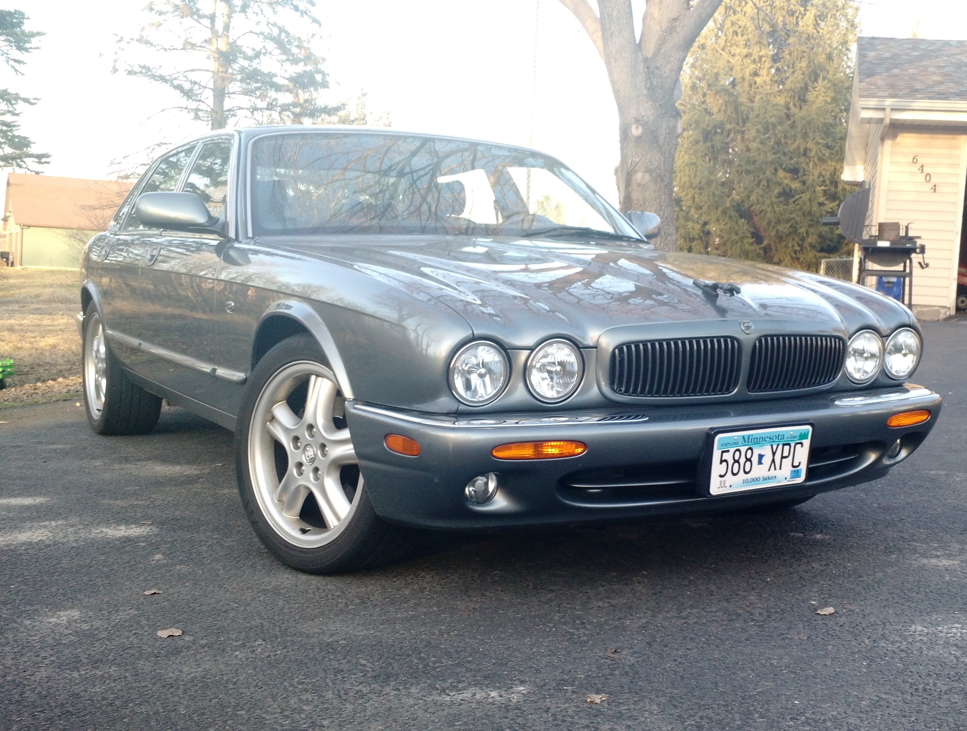

Last year I bought a 2002 XJ 8 for myself. The wife has a 2002 xj sport. I really liked the "blacked out look" so I decided to some work on mine.
First thing I did was paint the grille and the rear trunk trim piece. I really like the way it looks. I prefer it over the chrome trim. Then I added a blue tooth receiver so I could listen to my phone through the sound system. Today I installed a more controversial piece. I painted my leaper mat black. I like it. So far among friends and family its about 90% for and 10% against or neutral.
