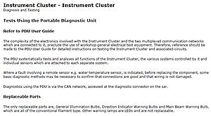

Headlight indicator bulb: Recently the green indicator light for the headlights stopped working and according to the workshop manual this is not a replaceable item as they are LED's. Well as it turns out when i took the cluster apart it isn't an LED, its a regular bulb sitting in a holder you can only access by dismantling the cluster. This is the kind of quirkiness that always amuses me about Jaguar. Why use a single bulb mounting style for the cluster when you can use a mixture of plug in bulbs, internally mounted bulbs, and LED's all on the one circuit board to do the same job
