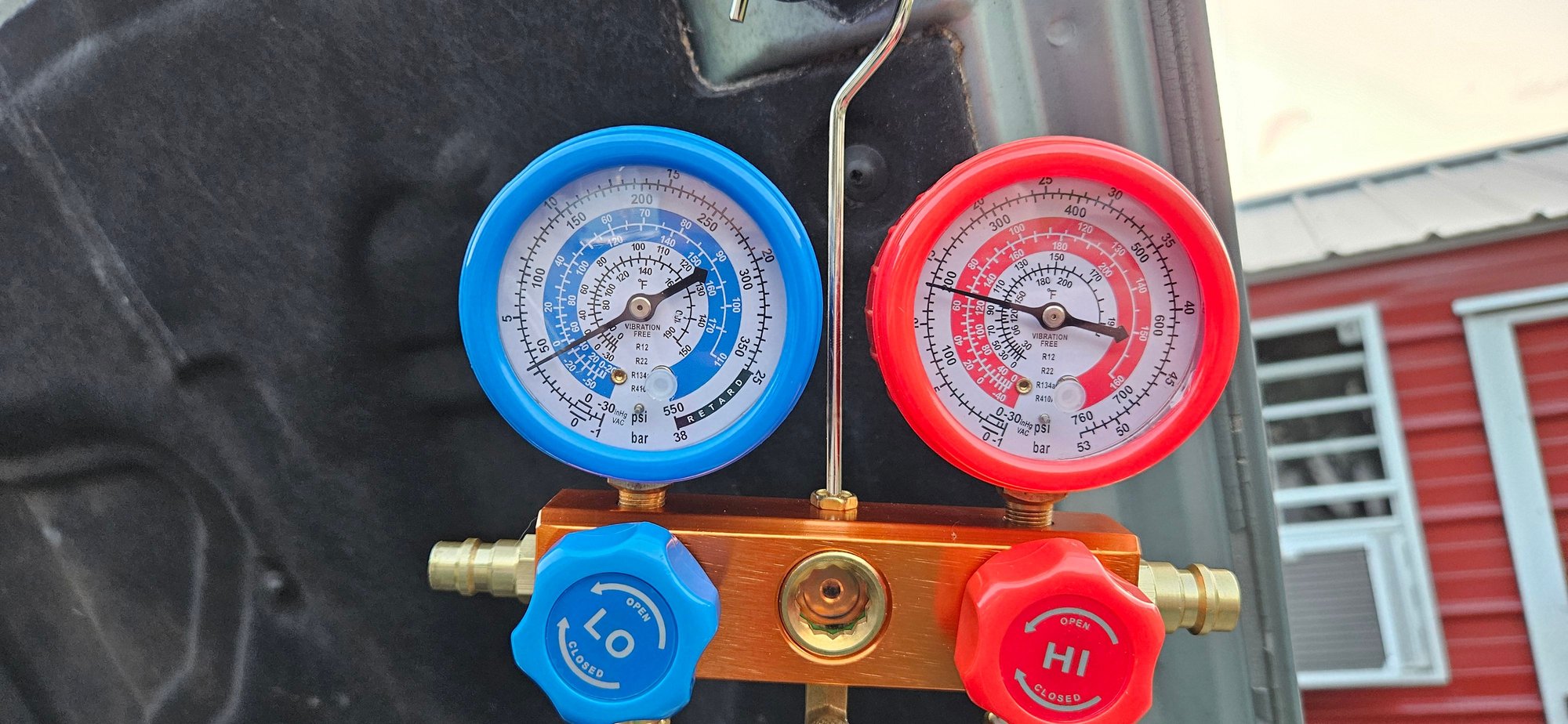

Added a couple ounces of gas to the aircon tonight, which was struggling during the day, particularly at idle. It was just about making 130psi at idle with ambient 84f. It's now back to being chilly cold. One of the flexible pipe to solid line crimps is showing signs of weeping so that'll be the fault. I can deal with a couple ounces lost over a year.

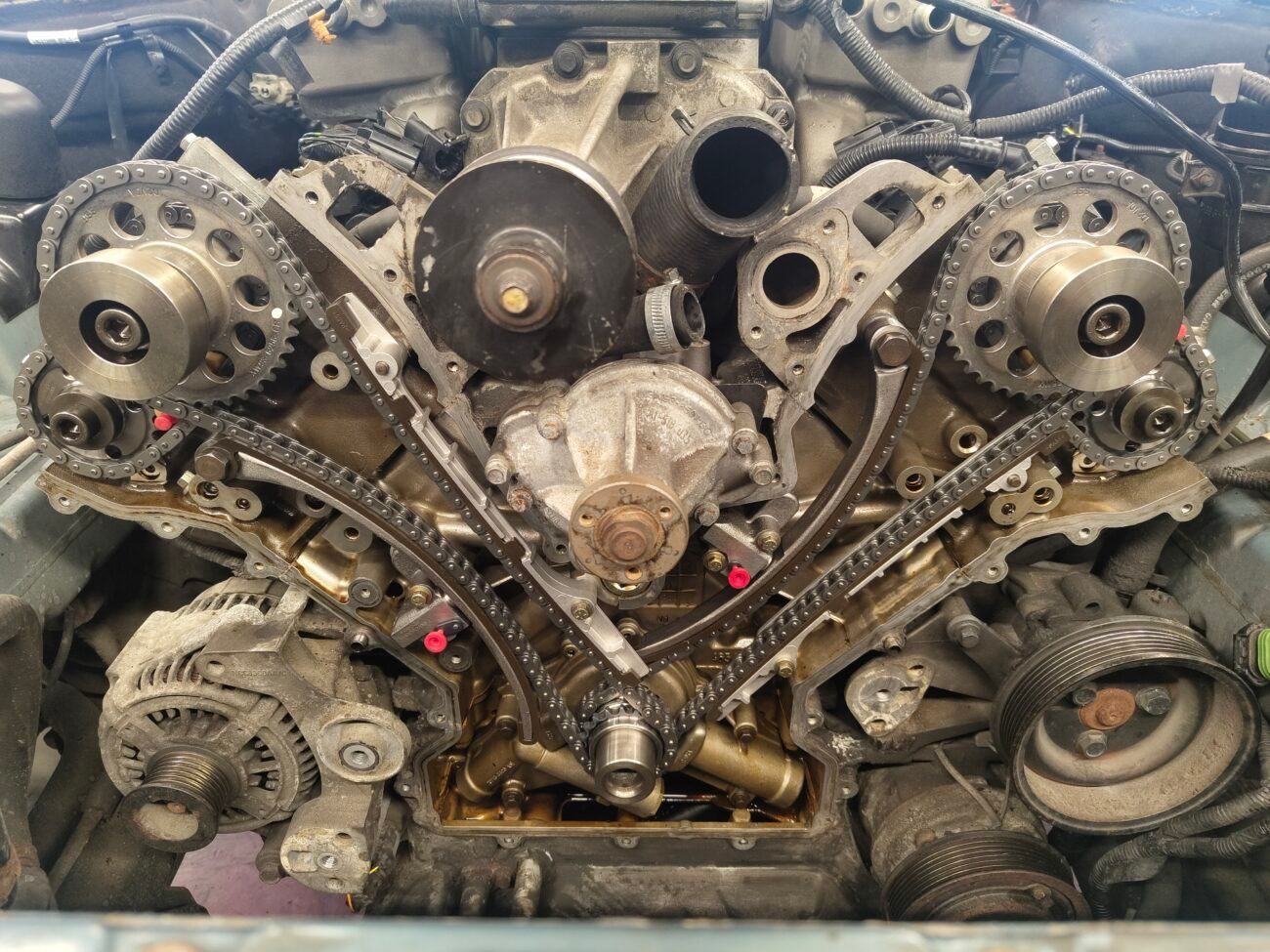

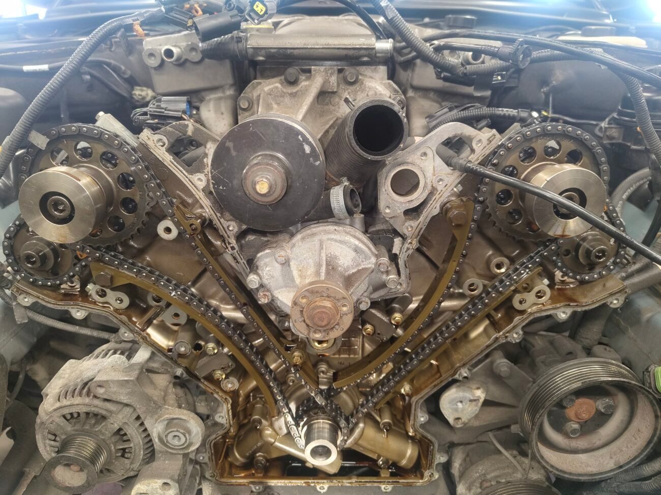

Started to do timing chain and valve stem seal replace.
In first glance. No dislocated plastics or cracked plastics on first gen? primary chain guides.

Judging by the colours, they are first gen the same as came out of mine late last year.
