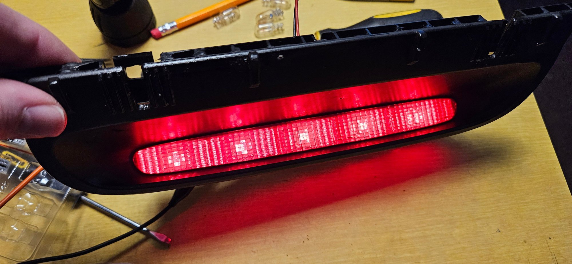

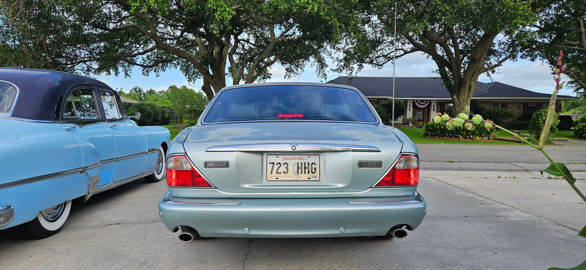

Upgraded the high level brake light.
Red T10 base LEDs. Total power draw now 9W, down from 25.
Certainly looks acceptable. Much more red than my phone's camera will admit to.
Got it all located correctly in the back window. Works for me.
Phil

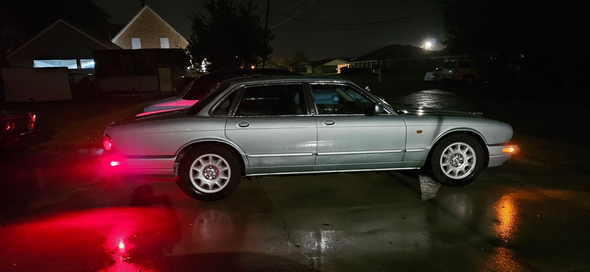

Going to find an alternative, these bulbs are great for the high level brake light but just a scosch bright for the clearance lights...

Bought some slightly more dim bulbs (single red chip).
That's better. These I can always pull apart and fit a higher value resistor in series because that's the only current limiting these have; the others were really smart and had a full on buck/boost circuit, they were up to full brightness by 8.7 volts and plateaued there in wattage. They also got really hot.
