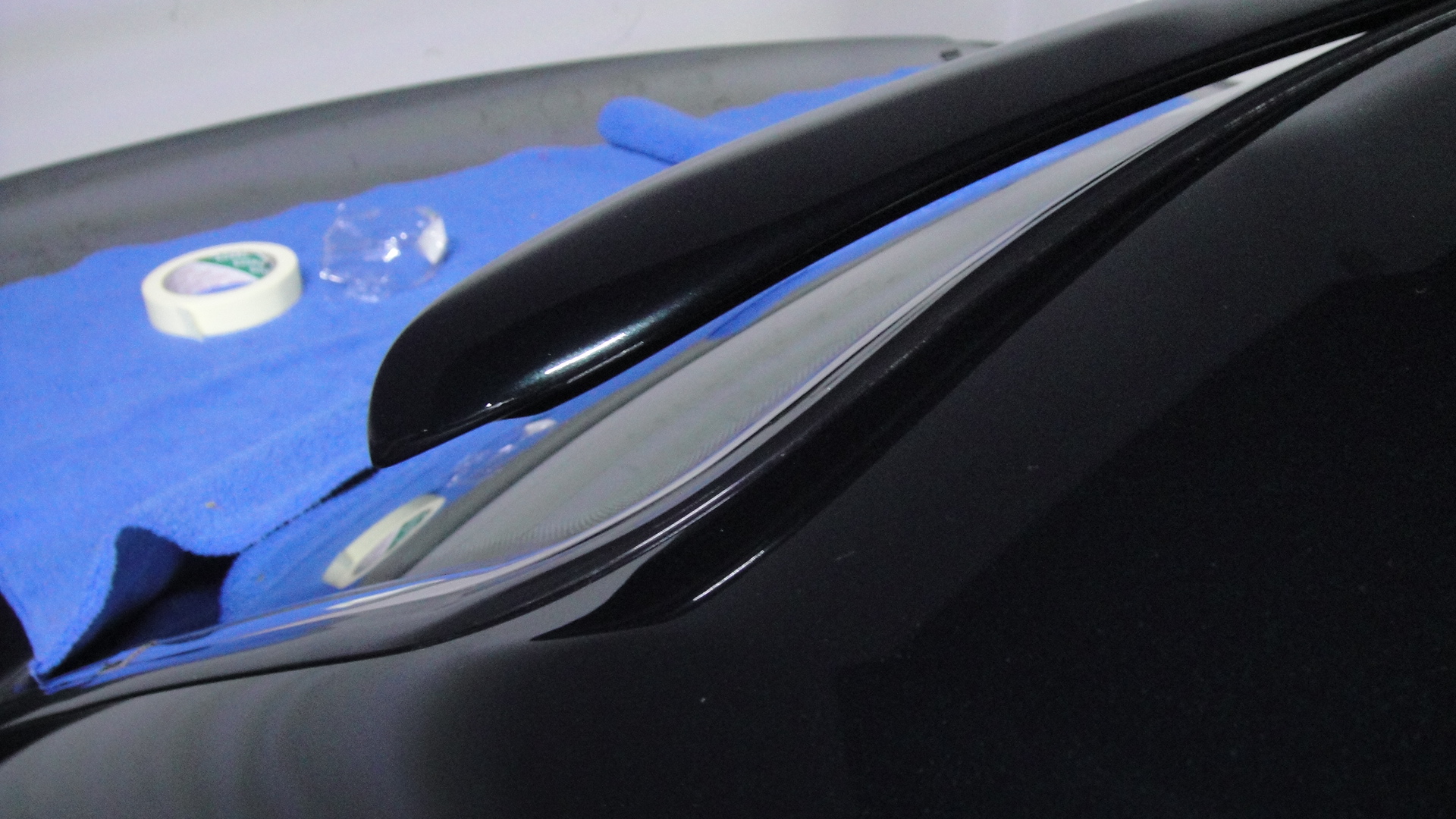

Received my long awaited roof spoiler last night, only to find out that not only the roof of a LWB is different (something I knew), but also the rear window curvation (something I obviously never realized ).
Back to the drawing board ...

Shame... What does something like that cost?
About a 100 euro, excl. shipping, unpainted, from Japan.
