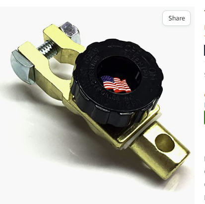

Lastly, I have one of these on all my cars. It's easier than disconnecting the battery cable and I always open the switch when fooling with something electrical on the cars. I find that if after tightening the knob up, I turn the key to the pre-start key position for about 20 seconds, then hold the pedal to the floor for maybe five seconds, let up the pedal, and start the car, it starts without going into a high RPM as it's re-learning the TPS position. (Learned this on the Jaguar Forum where I learn everything important...)
You can get these just about anywhere.....
Those battery cut-offs are very handy. On an X308, it is prudent to be sure your trunk lid lock operates with the key before you close the trunk lid with the battery disconnected (either intentionally or unintenionally). Otherwise you'll have to apply power at the false bulkhead stud to get the trunk open again. On many of the X308s I have worked on the trunk lid locks were gunked up and would not turn with the key. Cleaning the lock and making sure it works is good routine maintenance.
