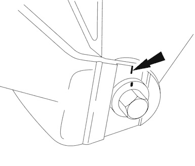

Is that a typo for a 2001 X308 4.0 Sovereign?
There is camber adjustment for the rear wheels although this is set during manufacture and, if any subsequent dismantling / reassembly has been carried out correctly, should not vary except for accidental damage.
Name:  X308 - CAMBER.jpg
The Rear Hub lower Pivot Sleeve (item 13) is a eccentric so rotation of the Pivot Pin (item 14) increases or reduces camber.
Further adjustment is provided by the Adjustable Spacer (item 16) on the bearings.
Whenever the hub is removed, it is essential to mark the relative positions of the flange and pin to ensure they are replaced in the same orientation.
If your rear suspension has been dismantled (or affected by potholing), it's quite possible the camber is out and this is scrubbing the rear tyres.
Attached Thumbnails Worn Tyres!!-x308-rear-hub.jpg   Worn Tyres!!-x308-hub-pivot.jpg
Pretty sure that adjustment is for toe.
The camber is adjustable by insertion/deletion of shims at the inner end of the halfshaft, or driveshaft in European terminology.

The camber is set by the spacers between the Diff output flanges and the driveshafts...the concentric bolt at hub/arm is for adjusting toe-in/out.
