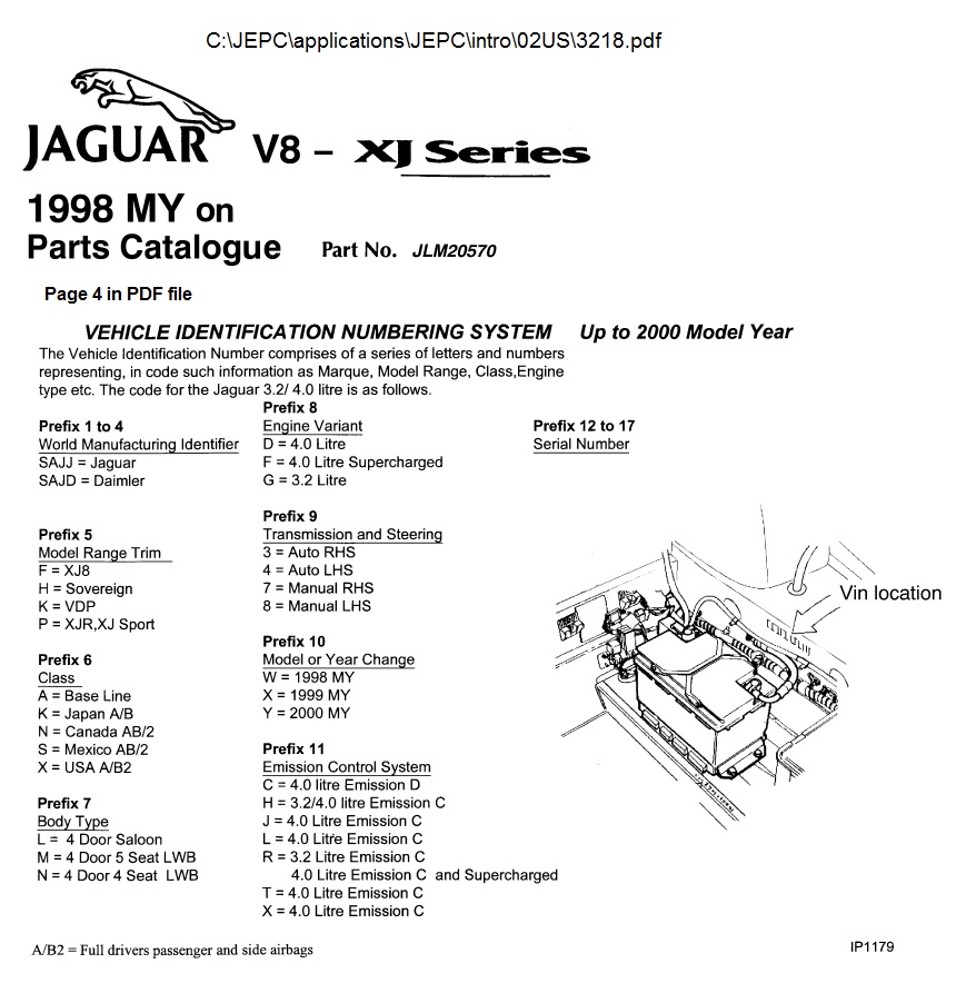

Hi
I found a vin decoder that seems to be correct for this vin code:
Jaguar VIN decoder Free VIN number decoder for Jaguar cars - VIN Number Decoder
SAJJJALG4CR831810
S - England AJ - Jaguar J - Jaguar
J - XJ8
A - Baseline
L - 4 Door Saloon (Series III & Limousine)
G - 3.6 or 2.9L ??? probably should say 3.2L
4 - Automatic LHS
C-Series III (Series III & Limousine)
R - Japan/Hong Kong 5.3 or Emission C
831810 - 123456 Sequential Number
Here is VIN Numbering System on Page 4 of the JEPC Intro PDF file:
Information on this VIN as viewed in PDF
SAJJ - Jaguar
J - ?????
A - Baseline
L - 4 door Saloon
G - 3.2L Litre
4 - Auto LHS
C - ?????
R - 3.2 Litre Emission C
4.0 Litre Emission C and Supercharged
831810 - Serial Number
