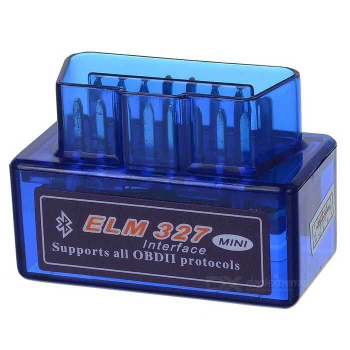

If you have an Android phone, buy a ELM327, in your location they cost next to nothing.
Then install a program like Torque or Torque Pro on your mobile, they are in the App store, also just peanuts money (mine came as a copy with my ELM327 from China ).
It needs a bit of setting up, but it will provide you with a wealth of information, which then might give you a clue of what is really going on.
We can help you there if it looks abracadabra in the beginning ...

Have a look at fuel trims at idle to see if there's a vacuum leak.

You use an OBD device. You can do it in a suit if you like, no parts swapping involved
