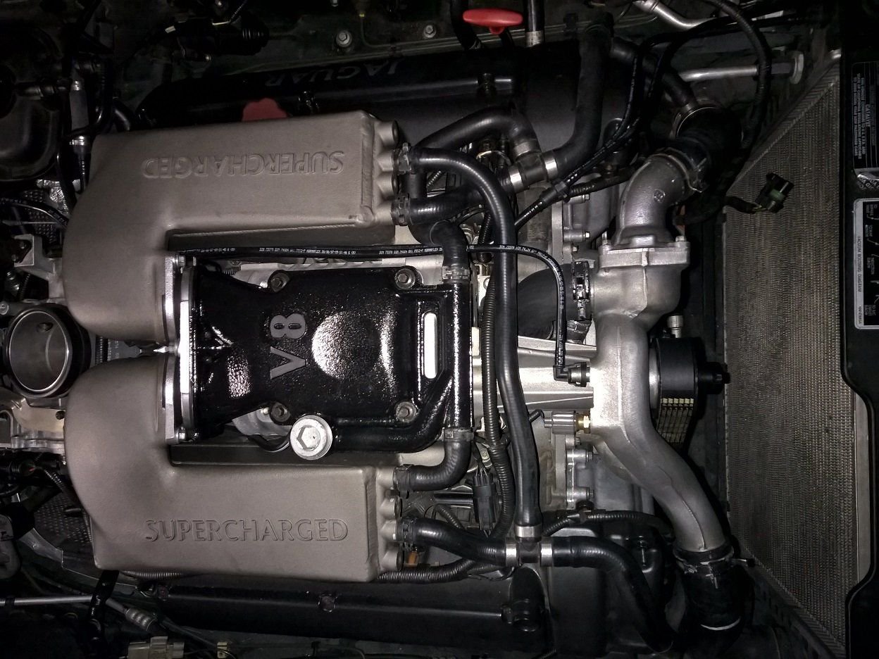

Without fan after tensioner replacement....
