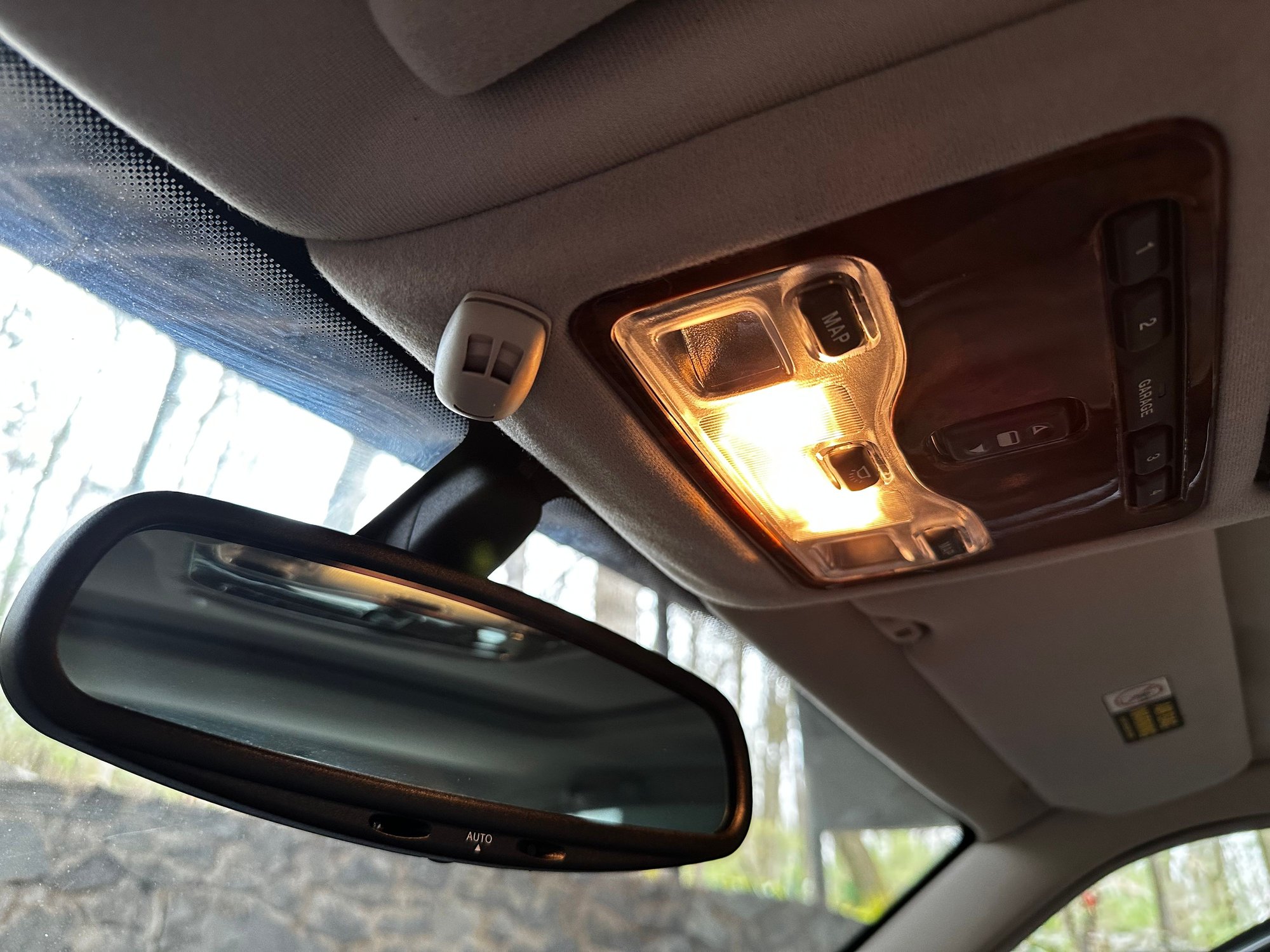

Hi, thanks for the fast reply. Sorry, I didn’t make myself clear at all.
My XJ was never fitted with the Motorola car phone with microphone that is mounted on the overhead console back in 1999 (see picture). However, I’ve just purchased the factory microphone hoping I will still be able to connect my Apple phone via bluetooth. Now that I have the microphone, I should be OK? Or, do I need an aftermarket option or the Motorola jag set up. I’ve seen a few of the kits online for around $500US

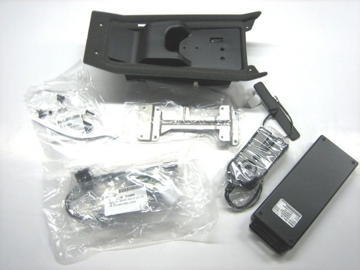

OK, thanks anyway. You will probably know what comes in the kit to install the phones? Does this look like it’s got everything in it? (Minus the handset of course)

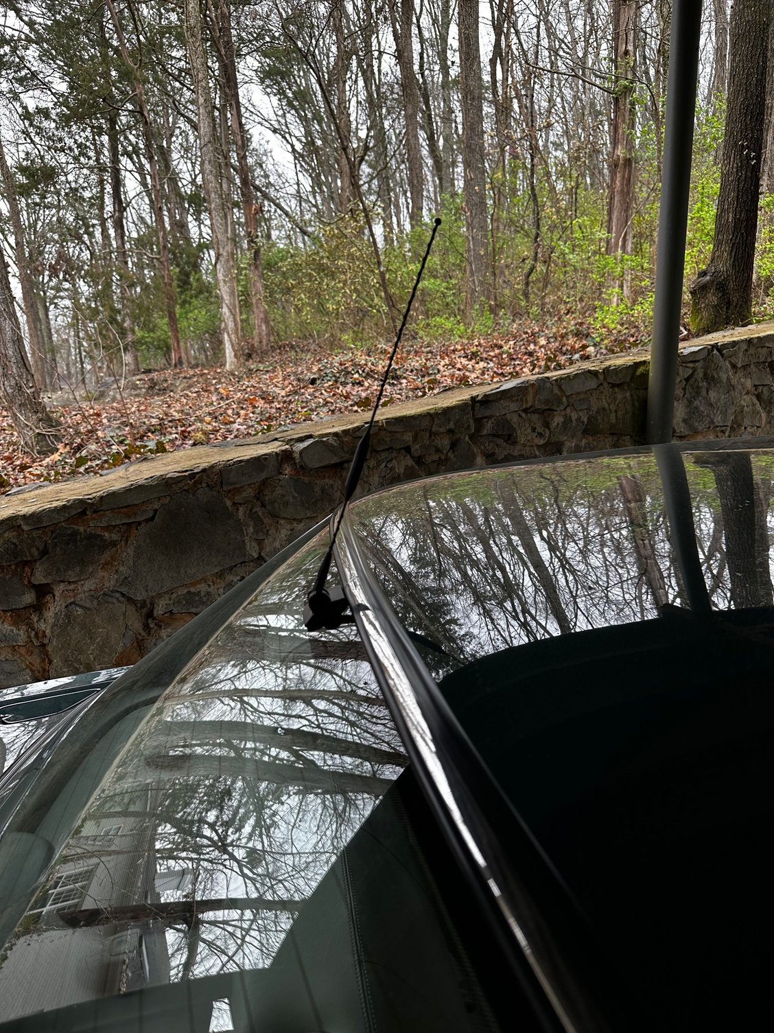

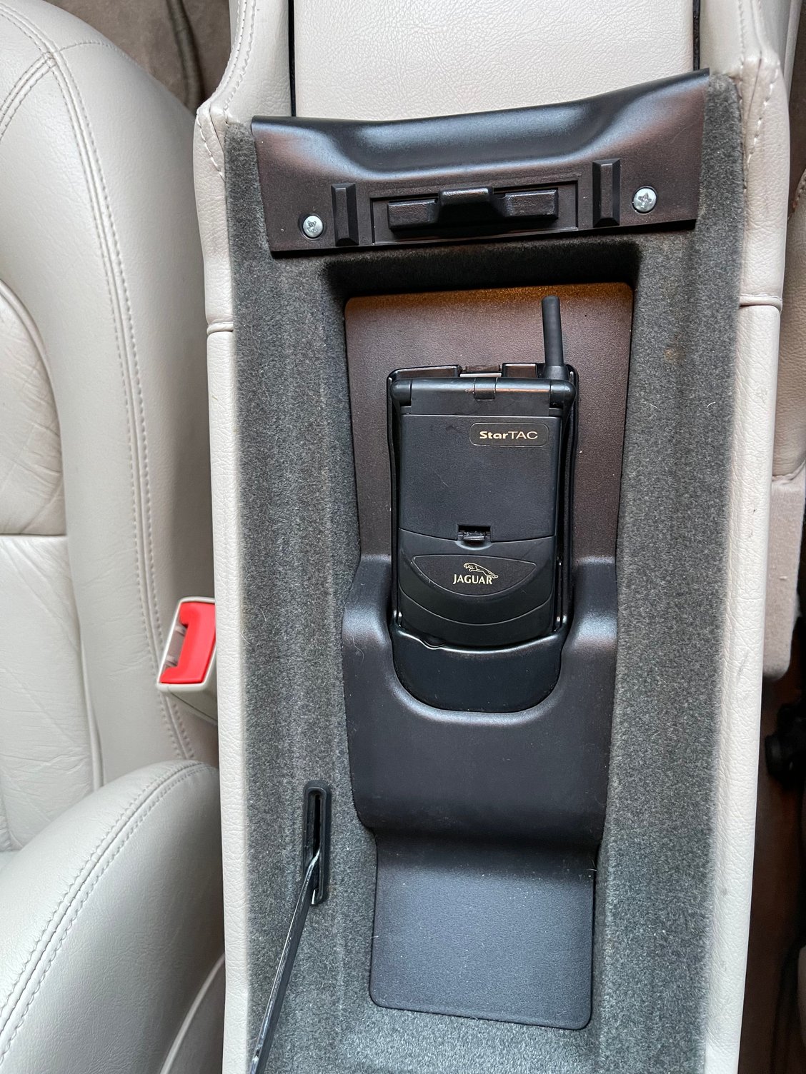

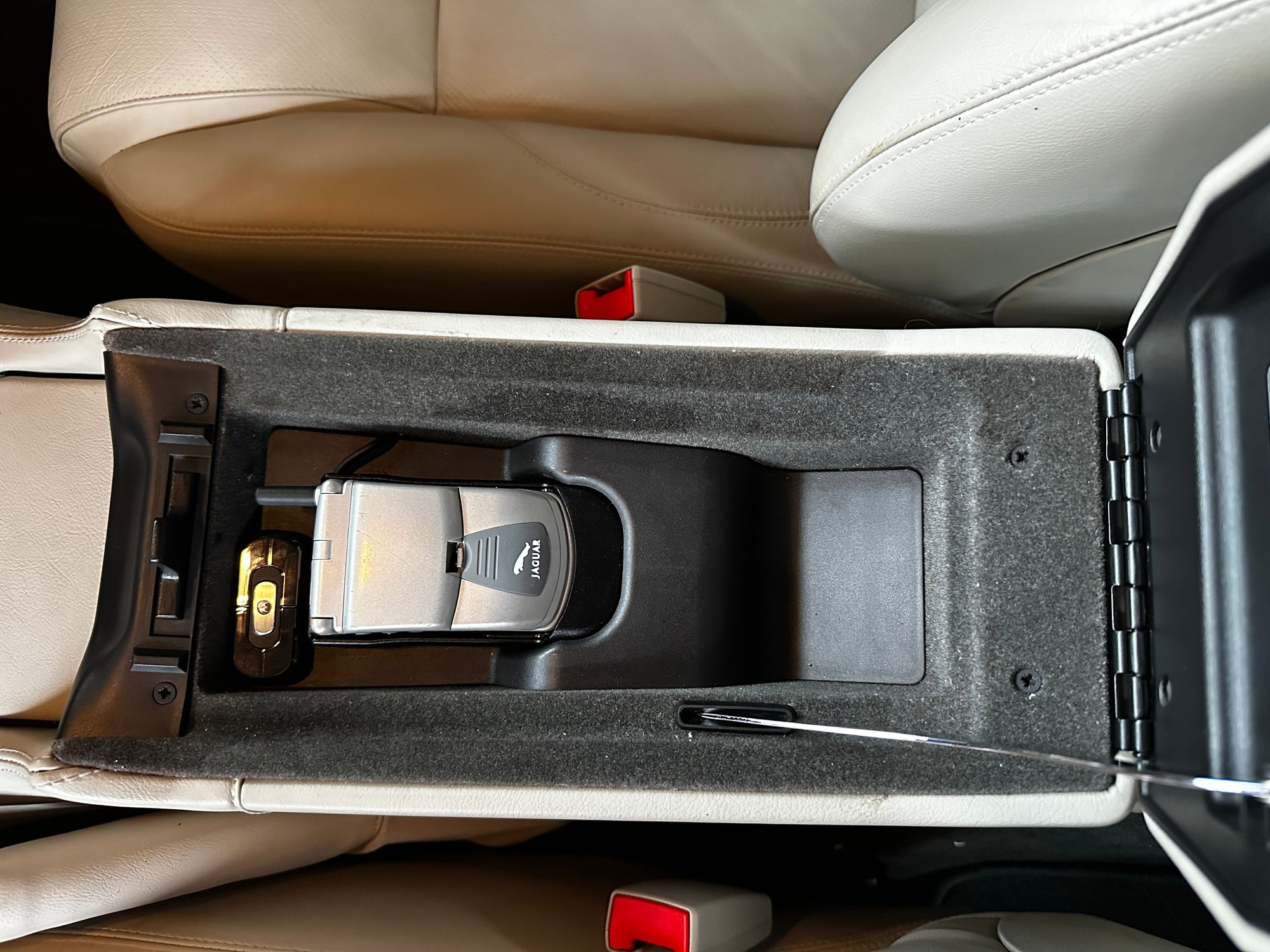

I bought the full factory phone set up, including the microphone, antenna, harness, cradle, box, wiring and everything that goes with it. I spent $20 on the phone $90 on the set up, $40 on an nos factory antenna, $20 on a new Motorola T-605 Bluetooth set up and $28 for a used oatmeal colored mic. I didn’t want to cut my cars harness, so I tapped into the secondary harness that came with the phone set up. I wired everything in, as Jim Roal had it online in PDF form and now everything works exactly as it should. When I get in the, the phone in the car beeps, as it powers up, the Bluetooth connects to my iPhone and I tap on my Pandora App and my play list starts. When I am receiving a call, it comes through the all the speakers, just as it did with the factory unit, I say, “Hey Siri”, answer” and I’m connected. If I’m listening to music and I want to make a call, I say, “Hey Siri, call **** ” and it’s that simple. When **** hangs up, the music comes back on from the paused point and all is good in the world. The only thing that shows is the redundanct little 1x3” remote, in the center console but you don’t actually need it, once you phone is paired, you can leave that under the center console, that is if your phone has voice control. I did however wire in my output from my CD player in the trunk because I just don’t use CD’s and longer. Discount Stereo has a harness to retain the CD changer but streaming is just so much easier and sometimes they skip over bumps. If anyone has any questions, please feel free to ask. I’m sure I’m not the only one who has done this, so forgive me if I over posted on the same subject.
The wire for the mic is not supposed to be exposed, for those who have the set up, the wire goes under the microphone, not alone to the side.
2001-2003 X308 (in the U.S) used the new Timeport, which took the place of the StarTac and the Startac took the place of the Princess.
