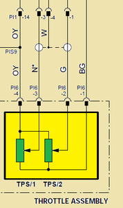

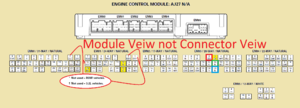

Did you read with a meter the 2 transmission speed sensors of a fundamental value of 1300 ohms ?
I'll get you a test of the 2003 X308 throttle body throttle position sensor ( 2 of them ) before you buy anything
TPS 1 : pin EM83 - 5 through EM81 - 10
TPS 2 : pin EM83 - 5 through EM81 - 19
Positions marked in yellow on the print I made for someone else
The Papa Indy 1 connector would be easier ( look for connector corrosion and clean ) at pin 14 through 3 and pin 14 through 1
These are sensitive shielded wires so check the shield grounds at EM81 - 24 and the ECU ground points including the ECU case ground .
Don't remove the TPS
What you are looking for is a smooth climb in resistance as you twist the throttle trough its range . A bad TPS will be an open or a bad spot on the range as the meter bips to high resistance
The TPS 1 and 2 Orange / Yellow 5 volt reference wire is tied into the PPS 1 and 2 and the fuel tank pressure sensor for North American vehicles only . Bonehead engineering .
