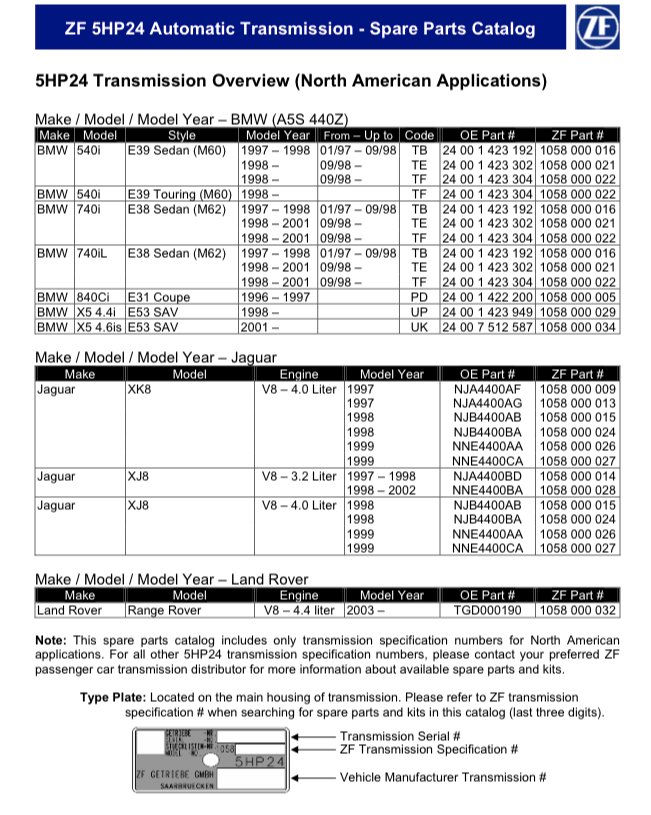

The important thing in understanding the inside of your tranny is which ZF version you have installed. In the XJ line, there were at least 5 versions used over the years (see extract from the ZF catalogue below). The catalogue is dated 2003, so why it stops with the 99 MY for the 8 cylinder cars is unclear. Perhaps the last version ZF used in the XK & XJ8 was the 027?? Regardless, you can see the tag from below (drivers (left) side as I recall)
When I did my tranny rebuild, I found the updated pressure regulator (& perhaps more importantly springs) that replaced the one identified as being problematic started being installed in the VB sometime in the 98 model year, perhaps when the 024 version started being used. However, the principal issue contributing to faults appeared to be scoring of the cylinder walls in the regulator housing allowing fluid to leak by the regulator. How / why this happened, I never found out, nor could I tell if the design change in the regulator was to address this. The only way to tell is to pull the VB and measure / compare the parts & look for scoring (as far as I could see on mine when I did my tranny job, there is no p/n stamped on the regulator). NB this applies to all types of cars using the 5HP24, not just Jag
ZF changed out the entire upper VB housing starting with the 026 version, so sometime around the start of production of the 1999 model year. However, folks have had tranny fails after this, so clearly the changes didn't address the root cause. NB this applies to all types of cars using the 5HP24, not just Jag as the VB is common to all.
The revised A drum seems to have been introduced in a least 2 steps. The exact date, I could never determine as the p/n was never changed, so the change does not seem to line up with a variant #. However, it seems that by about 2001 or so, the last version was in production, but I have seen reports on the Bimmer sites that the old version was still being provided as a spare by ZF well after that. The changes to the new version were a beefed up outer ring and an added oilway. NB that Not all aftermarket seem to be compliant with the mod to add the oliway (the one I used didn't have it) & I have seen reports of original style A drums being sold on E-Bay as recently as last year. NB this applies to all types of cars using the 5HP24, not just Jag as the A drum is common to all.
