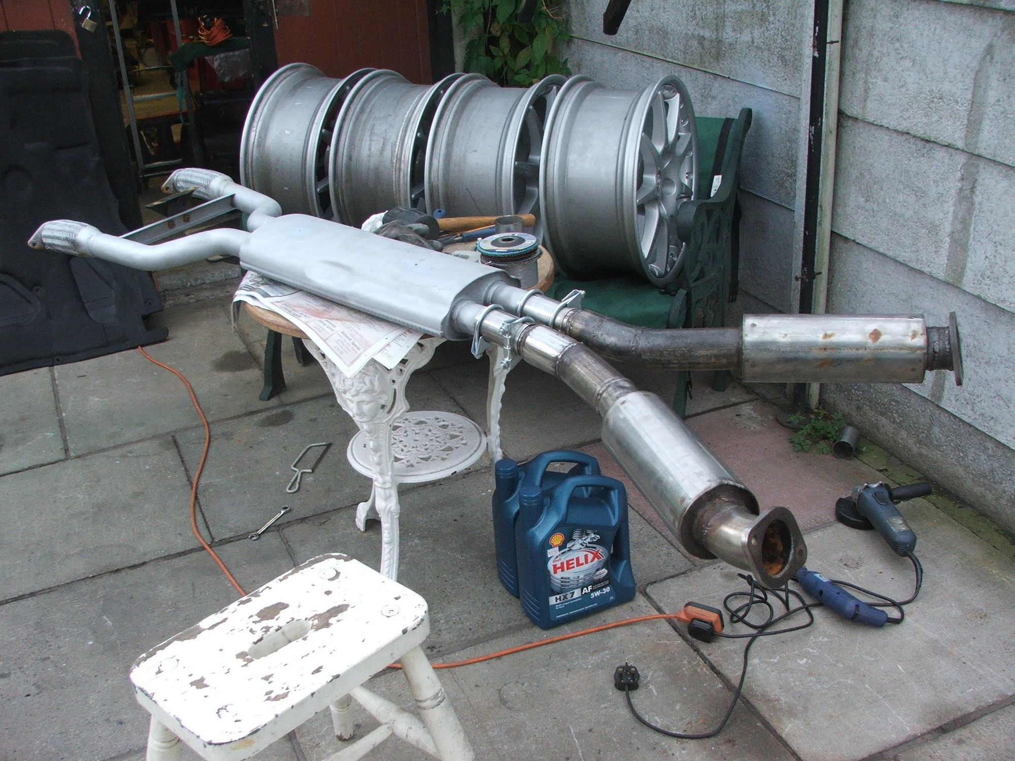

I've a Paramount Performance 'cat back' system installed, they did keep the big box under the trans, fitted a larger bore pipe from it to smaller 'before axle' resonators, then big bore over the axles to lengths of silencers. No drone at any rev range but it's more audible from inside and out.
- I must say this was taken 10 years ago and I've high flow cats fitted now.
