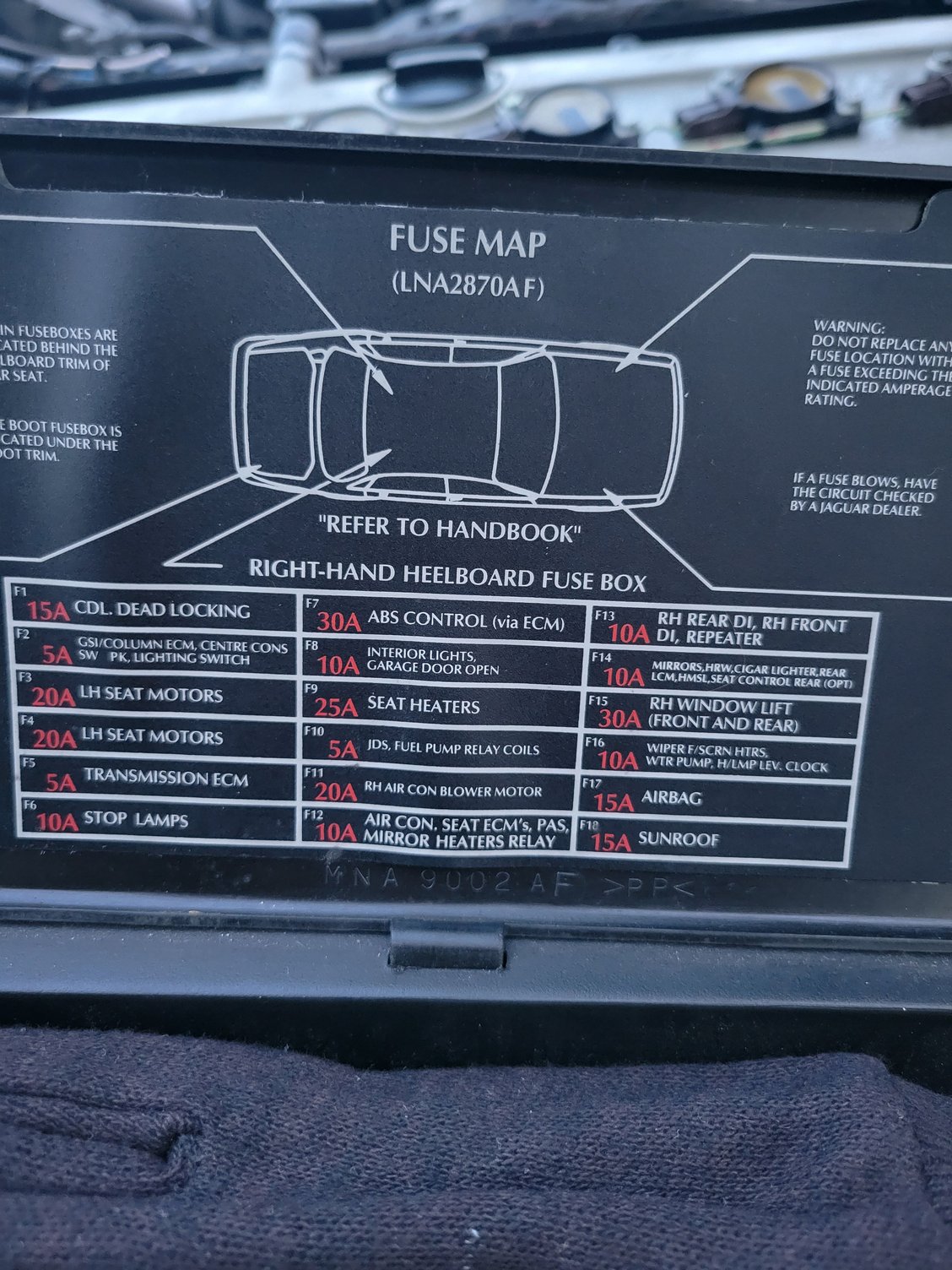

Is this the correct fuse to pull in order to do a compression check? I would've posted this in the x300 model section but that seems to be non existent for whatever reason.
fuse F10, (JDS?), FUEL PUMP, RELAY COILS

Pulling that F10 would work, but easier to reach F7 (30A) in the trunk which is the main fuel pump feed. Or you could pull the blue fuel pump relay which is the one in the green socket in the trunk box.
JDS = Jaguar Diagnostic System, the OBD port power supply.

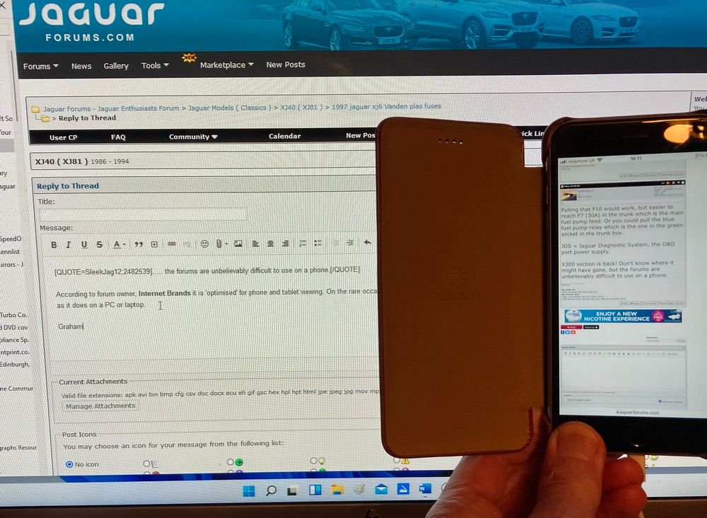

X300 section is back! Don't know where it might have gone, but the forums are unbelievably difficult to use on a phone.
Old Jan 6, 2022 | 10:16 AM
Likes: 17,009
Originally Posted by SleekJag12
..... the forums are unbelievably difficult to use on a phone.
According to forum owner, Internet Brands it is 'optimised' for phone and tablet viewing. On the rare occasions I'm forced to use my phone for the forum, I set it to Full Forum from the menu at the top left so it looks the same as it does on a PC or laptop.
I couldn't rotate the phone to landscape and show the PC monitor in the same shot but I'm sure you'll get the idea!
