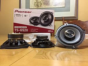

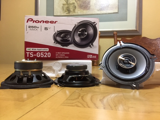

Pics of speakers attached (I think).. Pioneer TS-G520's, fit the 5 1/4 holes well (my old 88' used 4" woofers), and are more shallow in depth, no need for mounting modifications...
