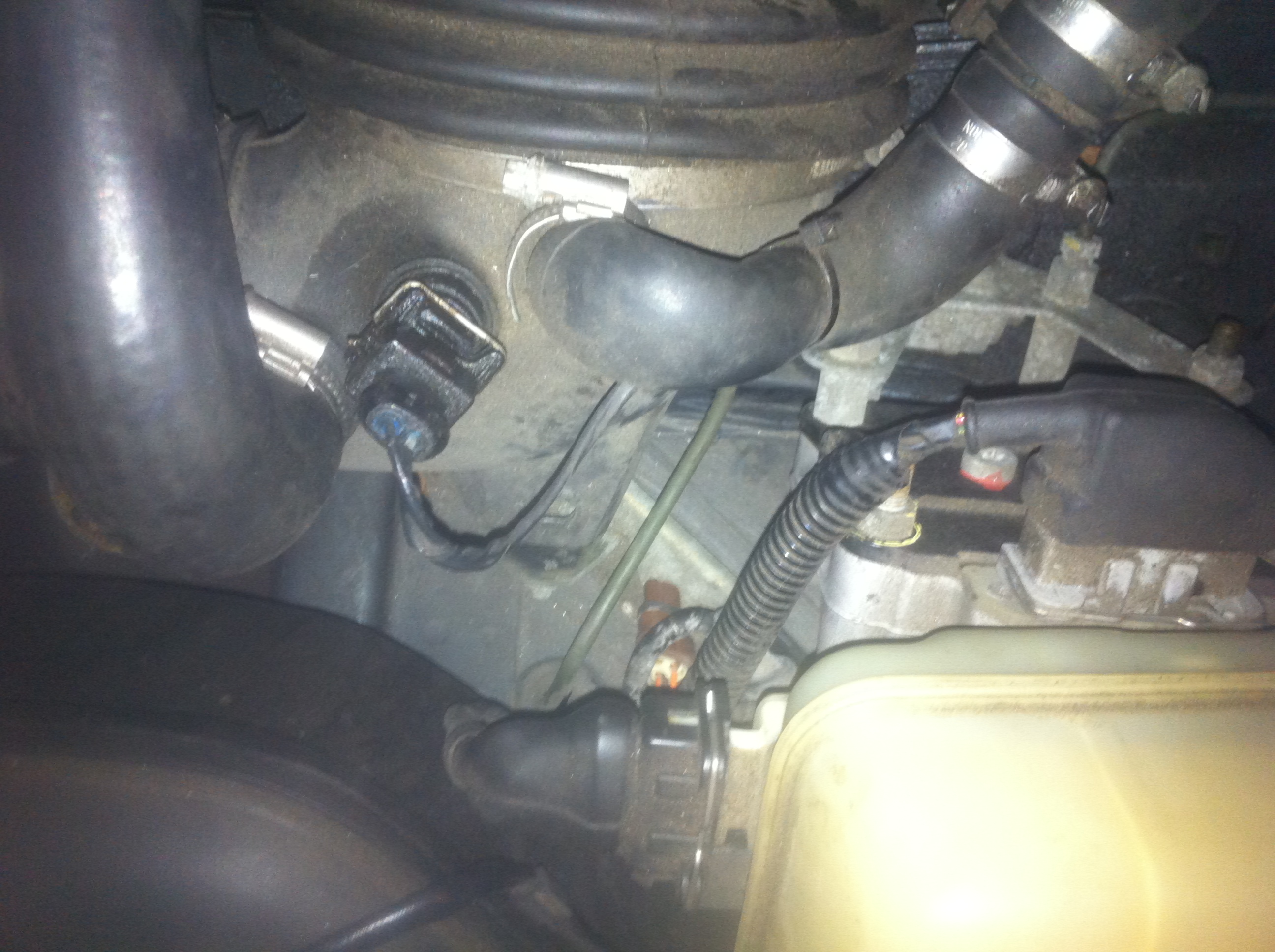

Old Feb 29, 2016 | 04:40 PM
jfleming's Avatar
Joined: Feb 2016
Posts: 25
Likes: 14
From: Long Island
Originally Posted by Lawrence
What are the colours of the wire(s) in the disconnected plug?
I've attached a photo of the plug in question. Today I have bigger fish to fry. Apparently I have a parasitic drain somewhere that just developed. Car's been fine, charges up near 15 volts even. Today I turn the key and with a little click everything shuts off: clock odometer, everything. Have to get it jumped and then go about a drain test... I left the blower motor knob on, but my blower motors don't work... Who knows, but the issue at hand here is the plug I've attached.

Old Feb 29, 2016 | 09:35 PM
Lawrence's Avatar
Posts: 2,729
Likes: 1,910
From: Victoria BC Canada
I just had a look on my car and that brown plug connects to it's female mate under the master cylinder in a clip on the fender well - the female end has a very short run (1" - 2") before the harness passes through a grommet into the wheel arch.
Have a good look with a flashlight at the fender area in between the coolant header tank and the master cylinder plug and you'll find the end you're missing.
Larry

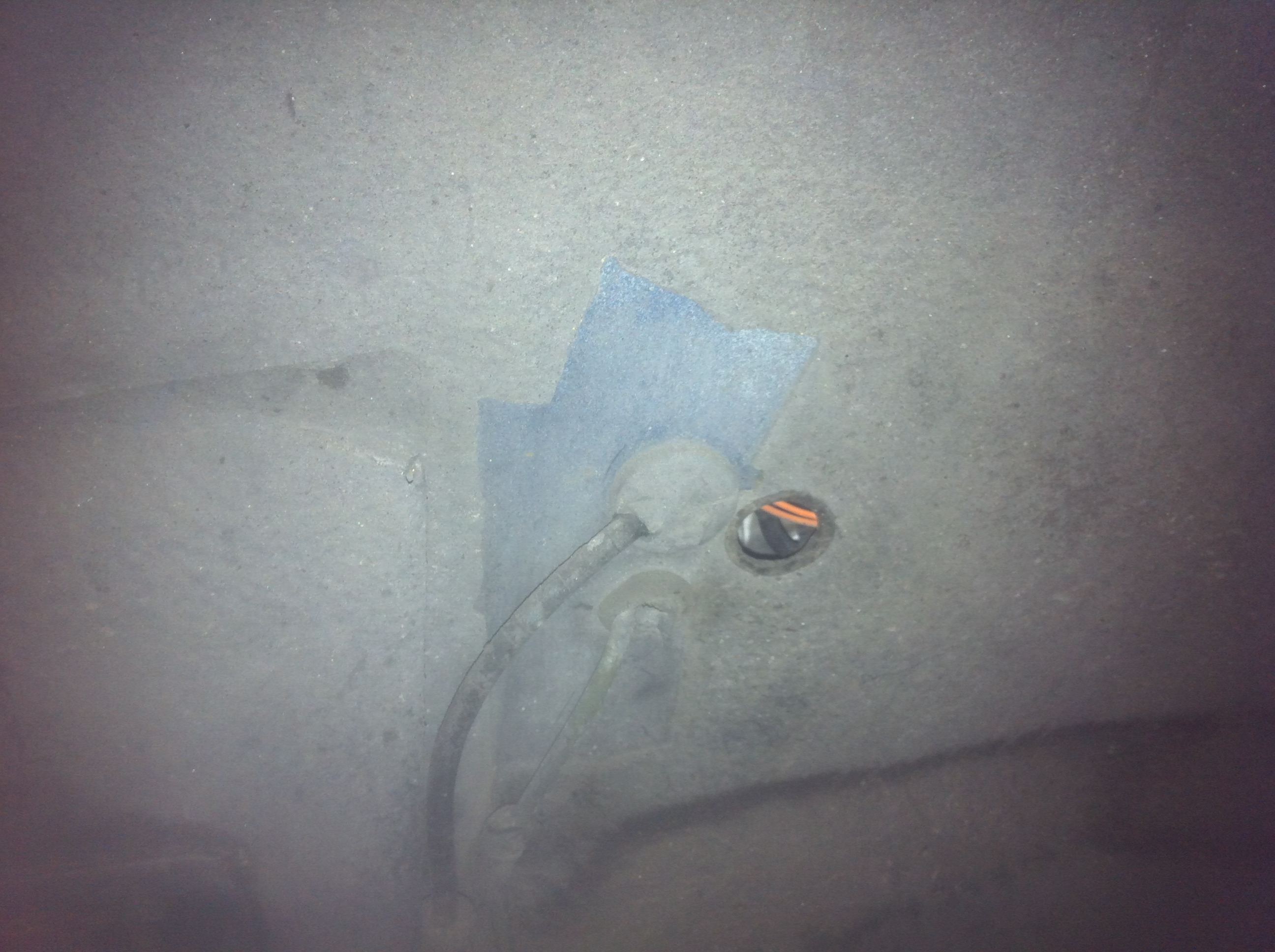

Old Mar 1, 2016 | 07:50 AM
jfleming's Avatar
Joined: Feb 2016
Posts: 25
Likes: 14
From: Long Island
Larry
So I think whatever It's supposed to connect to inside the wheel well (the brake system I assume) is missing! I have no female attachment and a missing grommet. I looked at the back of the wheel though and couldn't find any empty sensor sockets or the like.

Old Mar 1, 2016 | 11:08 AM
Lawrence's Avatar
Posts: 2,729
Likes: 1,910
Wreckers yard next stop then eh?
You might want to download the XJ40 electrical guide .pdf and figure out what exactly you're missing.
http://www.jagrepair.com/images/Auto...ec%20Guide.pdf
Larry

THANK YOU! It's the Left Front Brake Pad wear sensor. If i just jumper that connection it should go out right?
Old Mar 1, 2016 | 05:21 PM
Lawrence's Avatar
Posts: 2,729
Likes: 1,910
One way to find out I guess ...
Old Mar 1, 2016 | 11:22 PM
jfleming's Avatar
Joined: Feb 2016
Posts: 25
Likes: 14
From: Long Island
I jumpered the brown connector and that stray at the rear right wheel. Brake light, farewell! The pad wear sensors are cheap enough I may put new ones on when next it needs pads (and rotors). ABS light still on though, gonna have to pull all the wheel speed sensors and give 'em a clean. Thanks so much for your help! This is my new primary car and I'm looking to keep it for several years, so I do really appreciate your fast responses, since I'm actively using it.
