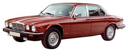

The XJ6 Series III is a rounded design and has twin windscreen wipers:

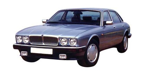

The XJ40 has a more square appearance and has a single wiper:

Attached Thumbnails Cabin filter & blower motor location-xj-series-iii.jpg   Cabin filter & blower motor location-xj40_1.jpg
