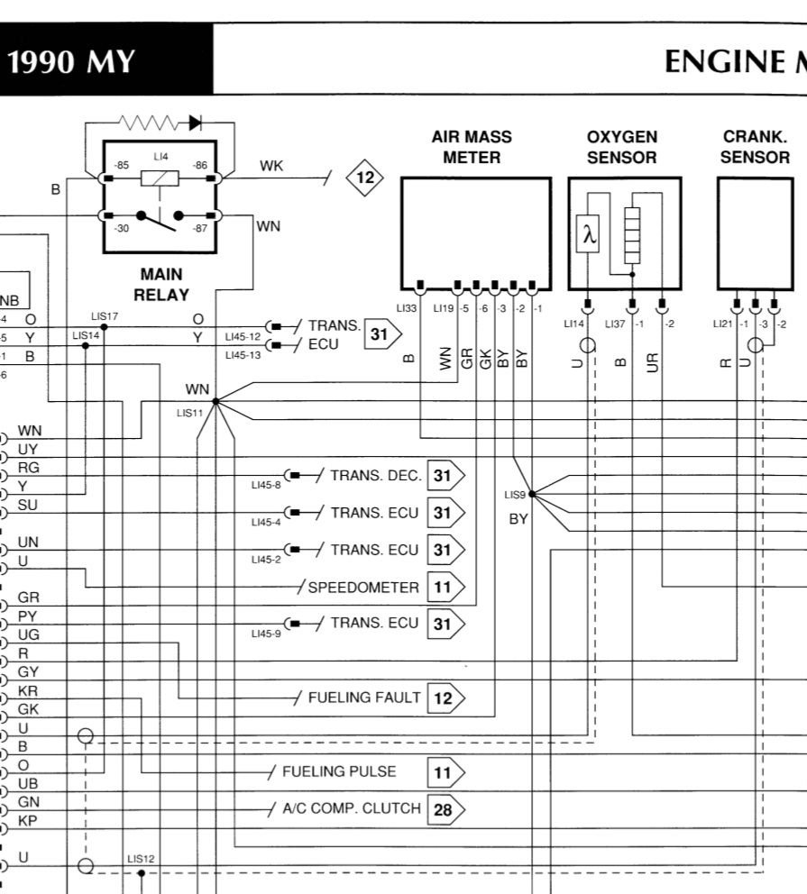

If youre not obsessed with originality, you can probably install an affordable sensor designed for the X300 ...the XJ40 sensor is ridiculously overpriced and is a three wire type where the X300 part is identical but with only two wires, signal and ground. The XJ40 sensor has a third wire which is just a shield. I doubt that shield makes much difference but if it does you could always shield the two wire section, shrink-wrap it and connect it to the car's third pin.

Both the XJ40 and X300 units are simple hall sensors and are physically identitical. The only difference is that the X300 unit eliminates the shielding wire. Probably the XJ40 shielding is employed to supress radio interference caused by the distributor. As the X300 doesn't have a distributor the sensor doesn't need the shield. It may not even be necessary on the XJ40, but if it is, you can modify the X300 unit to duplicate the XJ40 setup.
Take the 2 wire output from the X300 sensor and create a shield wire by wrapping the length with some other wire/mesh/foil. Mesh from a coax cable or the old sensor would probably be best. Sleeve the entire length in a tube of shrink wrap. Solder the shield wire you just created to the shield wire inside the car harness. Connect connect the two "working" wires to your existing harness plug. The wiring diagram will show you which wire is which.
I haven't done this BTW; but can't see why it wouldn't work. The dotted line in the wiring diagram below is the "third wire" - the shield.
Good luck!
