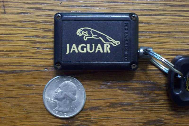

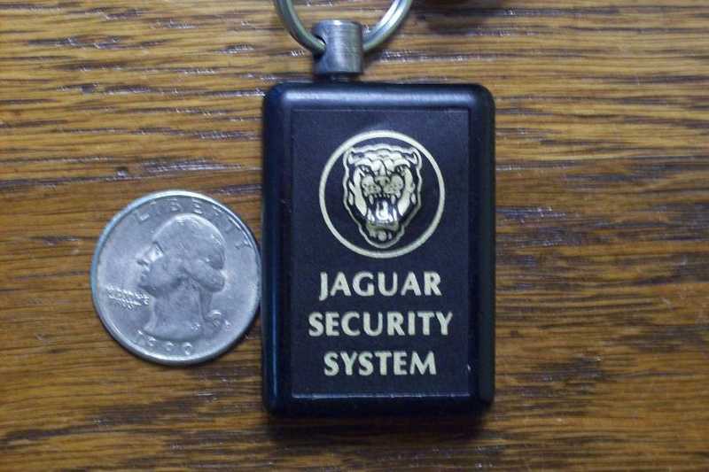

Is this the factory security fob? It has no battery. This car is new to me and I'm not sure what this does (when it has a battery ) It appears to only have the one button where the Jaguar logo is. Does this lock/unlock or just turn on a security system? Someone, not factory, has installed a red LED on top of the steering column. Could this be an indicator for the security system? Thanks for any info.

There is only 1 button on the key fobs that's correct and all the tasks can be done by 1 button . I ain't familiat with pre '93's system but in my Jag there is a LED in the middle of the console and it's for the security system so what you see in you car should be for security too

@Bob. Q. For info can you confirm that the type of transmitter shown in the pics is in fact for the 91 XJ. The reason is that my 92 has the older long rectangle one button affair with 3 batts in the end.

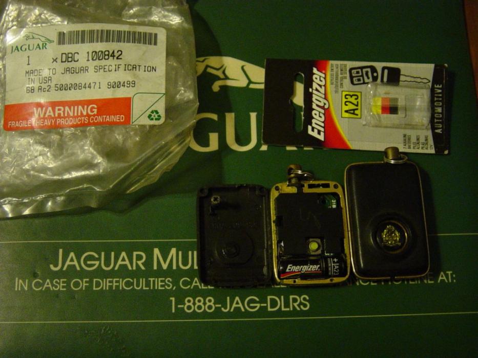

North America used the 318MhZ frequency and I have seen 3 different models of keyfob transmitters. The one pictured above and the two I have pictured. They all operate the same they just look different. If you order one from the dealer, you never know which one you will get!!
DBC100842
