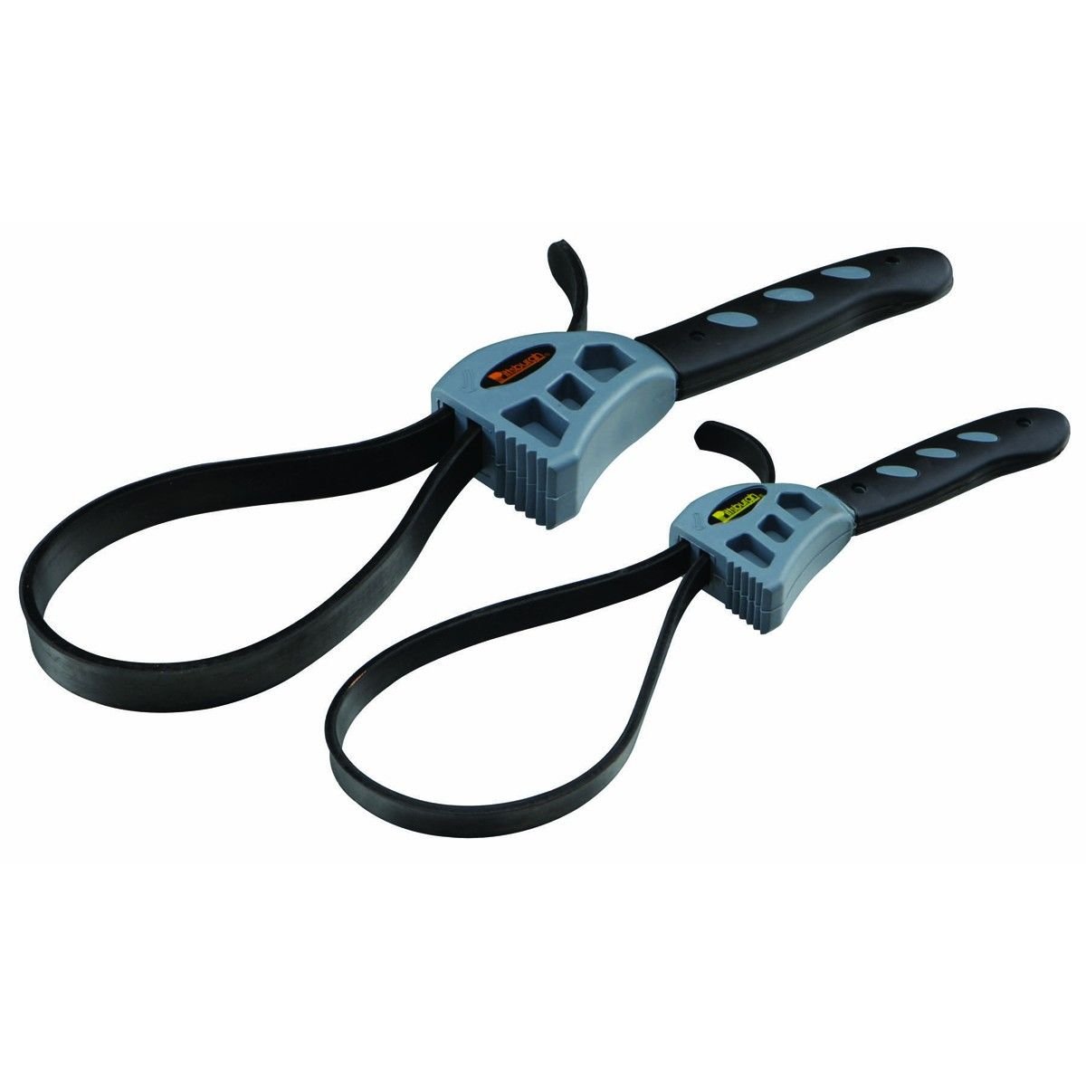

I too have a relatively low mileage '90 XJ40 (36 K miles when purchased last October). My coolant tank cap also leaked unless I literally cranked it down with channel locks. Purchased a new cap and found that it still takes more tightening than I would have thought necessary to keep it from leaking. I now snug it by hand as tight as my arthritic hands can handle to keep it from weeping but then cannot open it without the aid of the aforementioned channel locks. It leaks no more but requires that I keep the channel locks in my tool kit when travelling any great distance.
Old Jun 20, 2020 | 09:51 AM
Don B's Avatar
Posts: 20,487
Likes: 15,268
From: Crossroads of America
Tony,
A rubber-strap wrench will be kinder to your coolant reservoir cap. I kept one in the trunk of our '93. Harbor Freight carries cheap sets that work reasonably well:

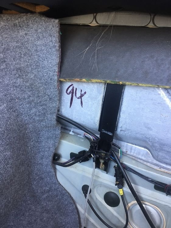

Today I took the trim off in the boot and tried wiggling the various wires around while the car was idling to see If I can get the car to shut off. It is really bugging me how it randomly shuts off. Behind the trim I found a loose blue jumper cable, any ideas what this might be? And also the number 94 written on the tank?
blue jumper
tank replaced before??
blue jumpere

Originally Posted by stran0020
Pardon the dumb question but how do I tell if the electric hydraulic pump is running? When park with the engine idling, every time I press the brake pedal the BRAKE and the ANTI-LOCK lights up. While driving every time I press the brake pedal the BRAKE light comes on and sometimes the ANTI-LOCK light comes on.
blue jumper
The BRAKE and ANTI-LOCK lights illuminating almost certainly means your accumulator is not holding sufficient pressure. You can tell if the electric pump motor is running by holding the tip of a long screwdriver or socket extension against the pump body (part of the accumulator valve block) and holding the other end against your ear, and having an assistant press the brake pedal. You should be able to easily detect the sound of the electric pump motor running. Search this XJ40 forum for a recent thread on sourcing a new accumulator.
I can't think of an explanation for that little blue jumper wire except that perhaps a previous mechanic has worked in that area to try to diagnose the same sounds you are trying to track down.
Regarding your intermittent stalling, it would not be a bad idea to replace the crankshaft position sensor (CPS) as a matter of course. These are known to fail intermittently and cause stalling and other difficult-to-diagnose gremlins, so many XJ40 owners just replace it preemptively to rule it out, and if the old one was working at least most of the time, put it in the trunk/boot as an emergency spare.
Have you checked your transmission fluid? To do so, drive the car a good 15-20 minutes to get the fluid up to operating temperature. Park on a level surface, and while holding the brake pedal, shift the gear selector through all the gear positions, holding each for at least 3 seconds. This fills the valve body and other passages to ensure a good fluid level reading. Put the gear selector in Park and set the hand brake, then, with the engine running, check the transmission fluid level. You may have to check several times before you get a clear reading on the dipstick. The fluid level should be exactly at the HOT MAX mark. Even a little low or high can cause problems, including stalling.
The blue Hella relays are known for developing malfunctions, so if you still have some in critical positions, it's a good idea to replace them with new sealed units (Hella, Bosch and Siemens still make these "ice-cube" size relays in 4- and 5-pin versions). Note that some relays have built in resistors and/or diodes to protect the contacts, so check the schematics and be prepared to add external resistors or diodes if required.
That 94 on your fuel tank may just be a match number used during assembly in the factory. You'll find those kinds of hand-written marks in lots of hidden places in your car.
