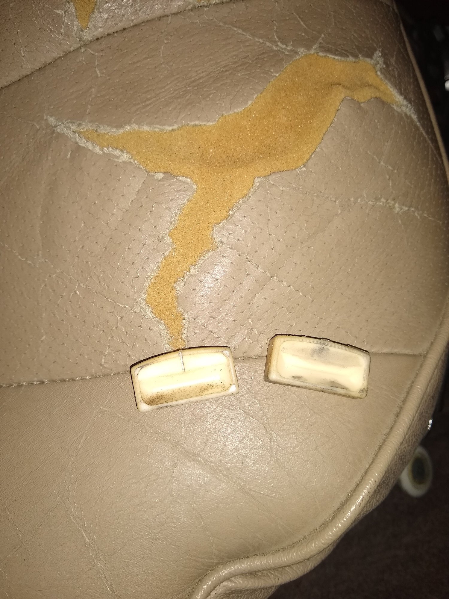

Hello everyone,
I have a 1994 Jaguar xj6. This is my first Jaguar. It has 4.0 liter engine. The car needs a ton of work and I am slowly getting things done. The front passenger side window stopped working while it was down. I took the door panel off because the exterior door handle was broke when I bought the car and I thought I could do both jobs at the same time. Well, as I was taking the glass window and motor out of the door panel, two rectangle shaped plastic pieces fell out inside of the door panel. I don''t know where they came from and not sure how to put them back. In fact, I don't even know what they do so I took pictures of them and I am hoping that someone experienced could guide me and give me some info about how to put them back on and what they do.
Thanks for our help.

I don't recognize those bits (size?) but they must be related to the window mechanism as that is one component I've never disturbed after removing door panels several times.
Possibly you can find them illustrated on the Jaguar parts website? Your car is classed as an xj6 classic 1987-1994 on that site

Thanks Larry.. Couldn't find it
Yes I am sure it has something to do with the window mechanism, which means that the window may not work without them.
They are about an inch long, half an inch wide and a quarter inch thick. I laid them on the seats and took these pictures.

Maybe they are a couple of things (wedges?) the PO stuck in there to keep the window up and closed?
Or why not take off the driver's side panel and have a feel around in there? Could these pieces be glued to the door skin?

I don't believe these two pieces I found in the panel are original to this car. I could not find their match on all other 3 windows/doors so I put it back together like it was supposed to be and it worked fine. It must be a loose connection or something weird.
