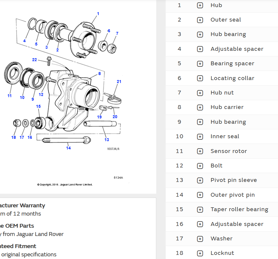

Back for some more... Finally got a chance to work on this and saw the lower carrier bearings are In less than great shape on one side. My question is about the seal itself. A few places like Barrets ( NOT IN STOCK) shows them with the seal attached but I have found others with out the seal. Is the seal supposed to be removable/replaceable or is it one piece?

Hi Jeh,
Do you mean part 15 in this diagram? I think some Jaguar workshop documents call these "fulcrum bearings," but the parts catalog just calls it a taper roller bearing. My recollection is that the Jaguar bearings come with a rubber outer seal attached, but a separate seal could probably work too. The seals are helpful because the bearings would otherwise be exposed to the elements and be even more vulnerable to corrosion. Also, the narrow ends of the pivot pin sleeve fit through the bearings and it is common for the pivot bolt or "outer pivot pin" to rust-seize inside the sleeve:

Jeh's Avatar

Hi Don
Yes thats the part. Are you aware of the part number of just the seal? I havent seen that anywhere. Even in the dry SW I cant imagine running that without a seal and it looks like its integral to the OEM brg. Ive got one bearing thats a little worse for the wear that Im going to try and clean and lube since it really doesnt move much. If it was a spinner like a wheel bearing no but this looks salvageable with some elbow grease and lube. But if its not Im down waiting for more parts again.

Don B's Avatar
Posts: 20,516
Likes: 15,287
From: Crossroads of America
Jaguar lists the bearing and seal together under one part number, CAC4610. I don't see any part number for the seal separately.
