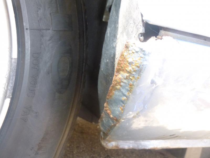

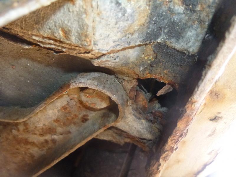

Hi chaps,
My '40 failed her MOT, first time ever - on rust! I have no idea as to how much cost wise & whether it would be worth doing.
These are the fail points:
1. Nearside front (outer sill) body or chassis has excessive corrossion, seriously affecting its strength within 30cm of the body mountings
2. Nearside front (inner sill) body or chassis has excessive corrossion, seriously affecting its strength within 30cm of the body mountings
3. Offside front (inner sill) body or chassis has excessive corrossion, seriously affecting its strength within 30cm of the body mountings
4. Offside rear (inner floor pan) body or chassis has excessive corrossion, seriously affecting its strength within 30cm of the body mountings
5. Offside rear (subframe mount / jacking beam area) body or chassis has excessive corrossion, seriously affecting its strength within 30cm of the body mountings
6. Nearside rear (inner sill) body or chassis has excessive corrossion, seriously affecting its strength within 30cm of the body mountings
Attached Thumbnails To weld or not to weld...-frontns.jpg   To weld or not to weld...-frontns2.jpg   To weld or not to weld...-frontns3.jpg

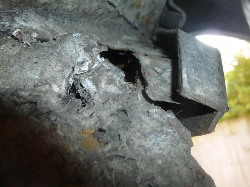

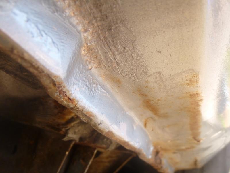

The previous post was showing the nearside front
This is the front o/side
This is the rear n/side
Attached Thumbnails To weld or not to weld...-frontos.jpg   To weld or not to weld...-rearns.jpg   To weld or not to weld...-rearns2.jpg

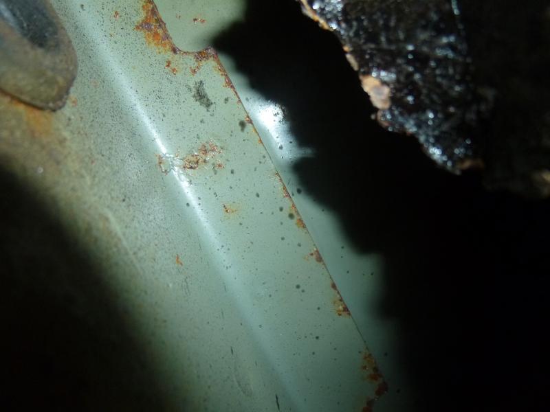

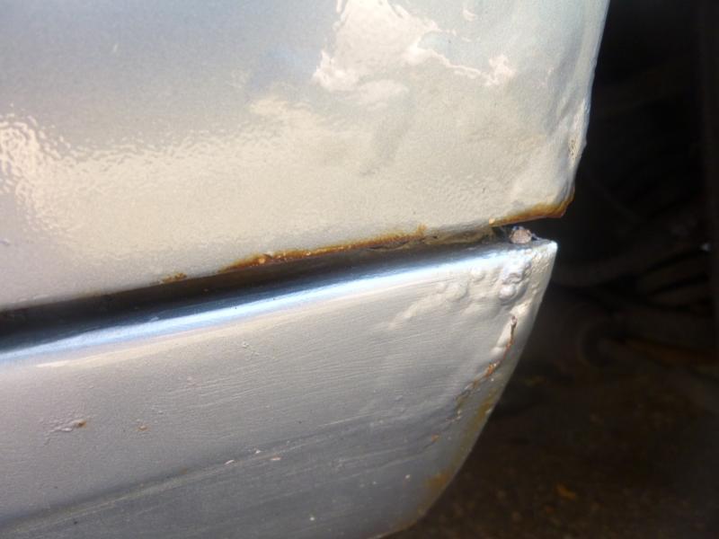

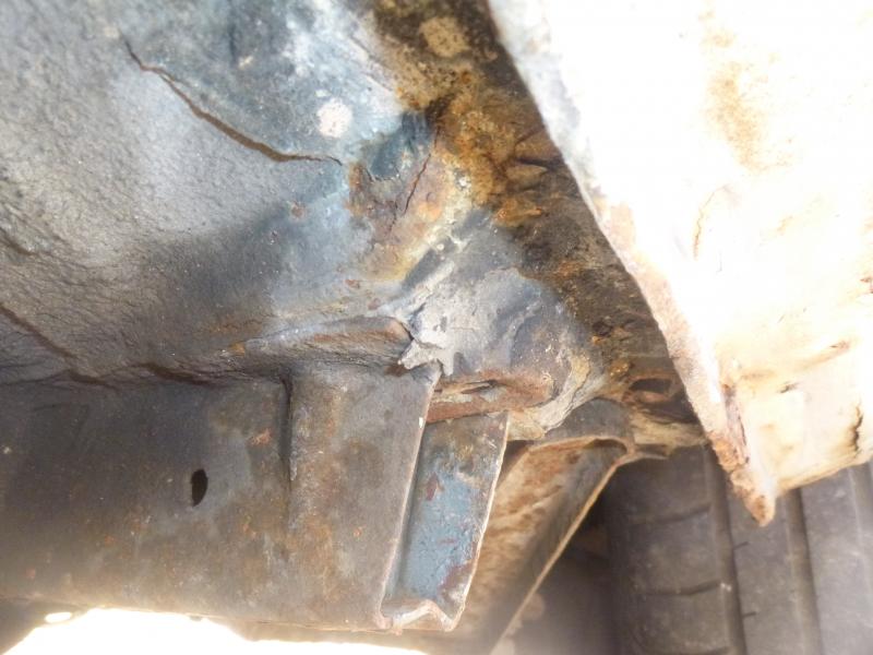

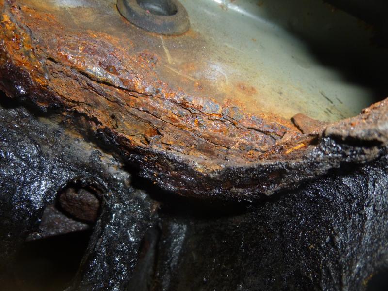

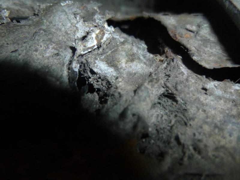

And this is the worst of it
Rear o/side
Looking into the hole
So is it worth repairing? Also, both A-pillars need doing as well
I'm just at a lost whether to scrap it and look for something else
Attached Thumbnails To weld or not to weld...-rearof.jpg   To weld or not to weld...-rearos3.jpg   To weld or not to weld...-rearos4.jpg   To weld or not to weld...-rearos4lookingdeeperintohole.jpg   To weld or not to weld...-rearos4lookingintohole.jpg

Well, pretty much anything is possible these days, at a price. I would think that the cost of repair would be economical suicide against the monetary worth of the car.
You could possibly recoup quite a pretty penny by parting it out yourself.
This is purely my own opinion and really it is up to you and how much you want the car.

There's a lot of remedial work needed to get it to MoT standard - and that's just from what's visible in the photos. It's always worse once you start cutting out the rot.
If you can weld and spray and have the garage space to work on the car, it will be very time consuming but not hugely expensive. If you're considering paying to have the work done then best to accept the inevitable and get what you can for it. A replacement Jaguar is going to cost a whole lot less than the repairs.
