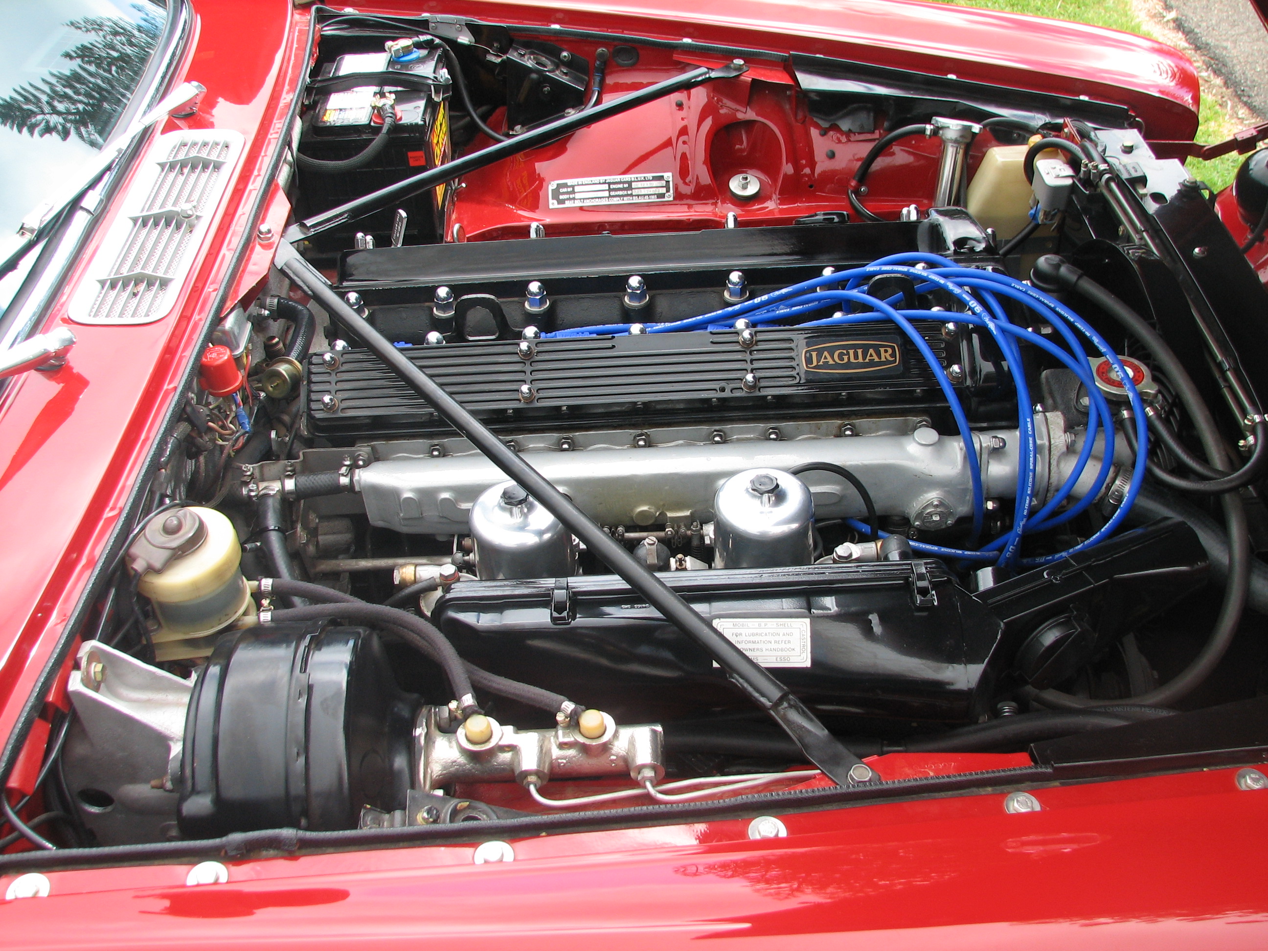

Found this picture...Looks like the routing is to ease assembly.
http://www.myjaguarstory.com/resourc...2010%20007.jpg
OMG that's a beautiful engine bay! I don't need to see pics like that...
