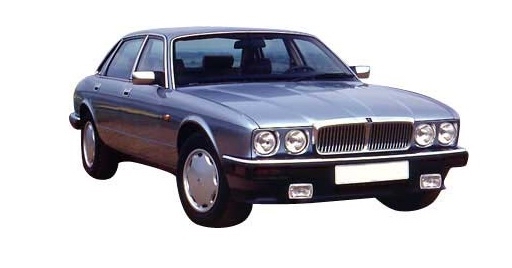

Old May 14, 2013 | 02:04 AM
Likes: 17,015
Time for an XJ6 Picture Quiz!
A. XJ6 Series III
B
. XJ40
Old May 14, 2013 | 06:39 AM
White Jaguar's Avatar
Joined: Apr 2013
Posts: 27
From: Wausau WI
Thanks for the pictures and a little bit of history.
My car is picture A.
My headlights are split with the bonnet.
Thanks again.
