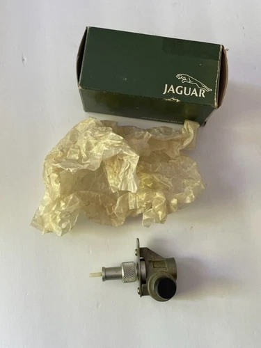

Hi
I just replaced some light bulbs in both speedo and tachometer.
The speedo needle has been a little wiggly (in low speeds) so I suspected a bad speedo cable a long time before changing the bulbs.
A short while after, the speedo completely stopped working. The cable is totaly broken off next to the angle gear.
My angle gear has a plate with a slit pointing upwards, the slit could possibly fit a "position-pin" in the lower half backside of the speedo,
but it i doesnt because it´s pointing in the wrong direction and the angle gear has a very long connection to the speedo (or position pin to short)
The angle gear points to he right (LHD-car)
Questions:
Do I have the right kind of angle gear?
Is my cable routing correct?
Where can I order the correct parts?
Regards
Martin

Originally Posted by MartinJohan
Questions:
From this [not outstanding] illustration the angle drive looks correct....but the length of the stem obviously isn't shown
DD

Thanks for the reply!
That angle gear would fit my speedo, the slit in the plate match the position pin, and without the stem the length of position pin is enough.
But unclear how to fasten it to the speedo without a cap nut?
Also the picture show that the cable goes to the left, is that correct for a LHD?
The nut isn't shown in the illustration. A replacement angle drive will have a nut
https://www.ebay.com/itm/175754936369
