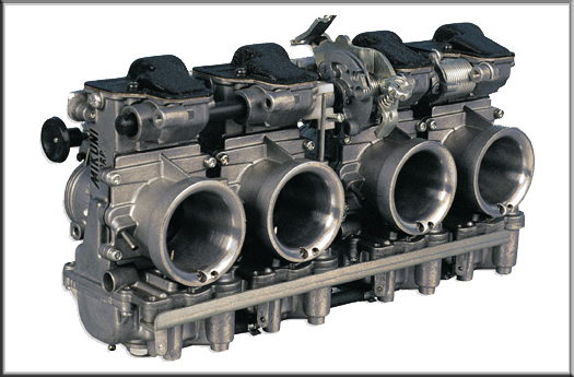

I mounted a set of Mikuni 34mm flat slides(I took off a Suzuki GSX1100) on a mini 850. Cost a few pay packets but it was worth while. Don't know the details of what was done as I was single and had cash to pay to have it done.
But it improved the 850 mini no end. My parts guy(Stan) from my local Suzuki motorcycle dealer did the conversion in 1992. I still buy bike parts from him today at the local Triumph/Suzuki Dealer

Some of the carbs are modular, like the Honda ones, so it would be easy to get two sets, delete one of the middle ones and run two sets of three carbs, simplifying linkages, or run all 6 joined but the issue there might be inlet port spacing

Three of these would be very amazing but the tricky bit would be the ECU.
The ECU likes to control pairs of injectors, not 3 of them.
These are equivalent to 1-1/4" SU carbs, so three of them would do the job.

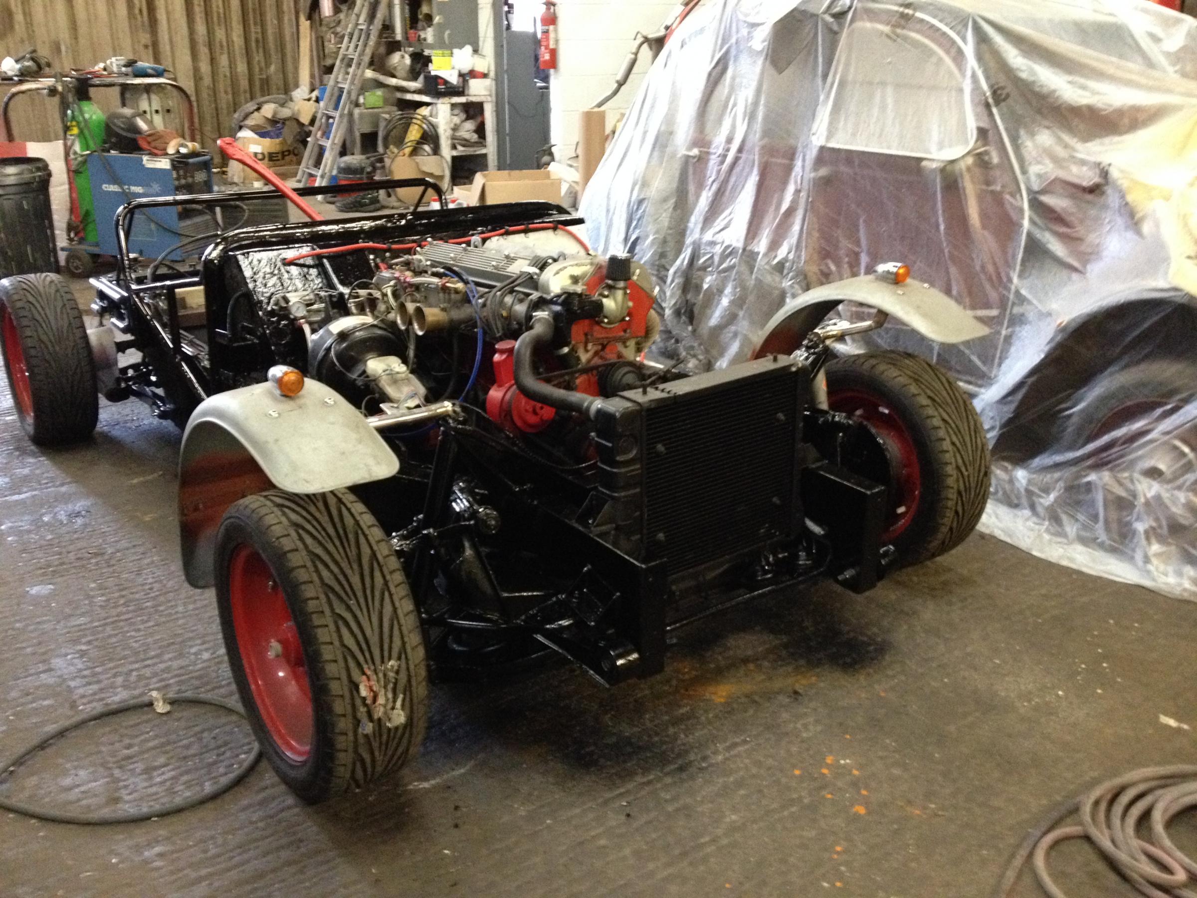

i have a modifyed su inlet manifold for twin webber 40/45/ 48s it was a proto type manifold my dad had made for his jag engine car i have taken it off and ready to sell now.
bike carbs are realy not a good option unless being fitted to a small engine car of a simeler size cc to the bike the carbs came from.
i have a friend with a mk2 escort with a 4cyl 2.0cc and a ford st 170 fuel injection engine that was 170 bhp standard. he bought it with bike carbs on it and it was only 147 bhp.
so it was less than standard.
he recently bought 2hand manifold a webber 48s and had another dyno this week and it was 186 bhp.
so bike are not all people make out to be.
I now have bought mk10 420 triple hd 8 2inch su carb set up to stay original for mine.
