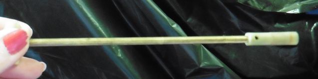

That "bolt" is only nylon and not tight at all. Should be only finger tight.
And then you'll find a brass tube about 6 inches long with another nylon fitting over it that activates the horn.
Getting this back into proper position can be fiddly.
