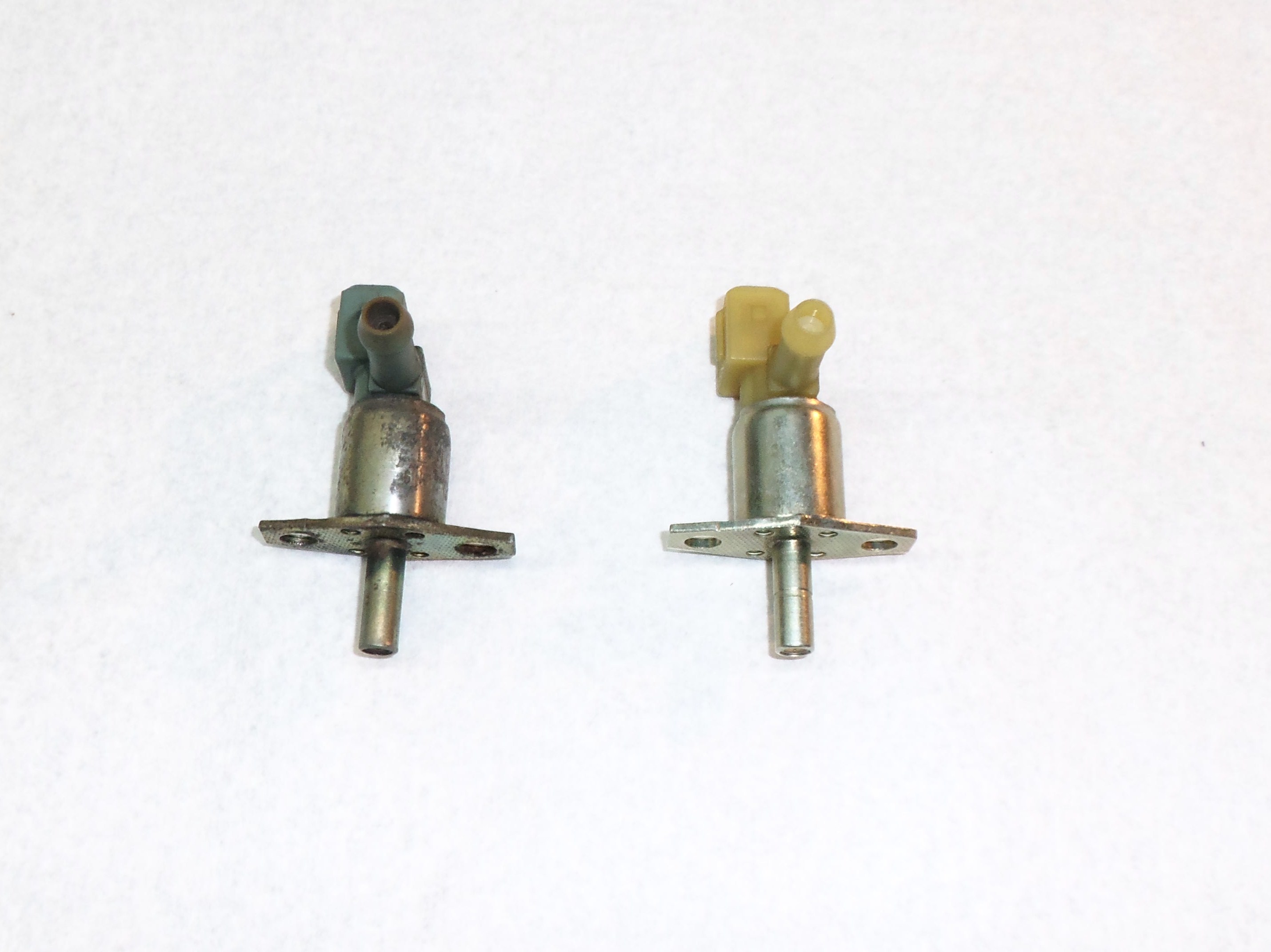

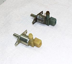

Hello,
I just wanted to share with you, I just purchased a new Bosch Cold Start Valve through Rock Auto for $43.78. They're having a wholesaler closeout, and there's about 10 of them left. The old and new valves look identical and both read 3.6 OHMS when tested. I'll put the new one in when the temp outside gets above 25F, but I have no doubt it should work fine. (the old still clicked, but was clogged. It's going in the soaker for a spare.)
The P/N that I ordered is BOSCH 0280170036. RockAuto lists it for a Renault Alliance and Encore, 1983-1984.
Hope this helps someone.
George.

Good sleuthing.
I also suspect it'll work fine but, still, I can't help but wonder if the fuel volume/flow is calibrated differently. The same design injector was used in many different applications and engine sizes. One would think that 2.0 liter four cylinder engine would have different cold fueling requirements than a 4.2 liter six-cylinder.
Let us know how it works out !
