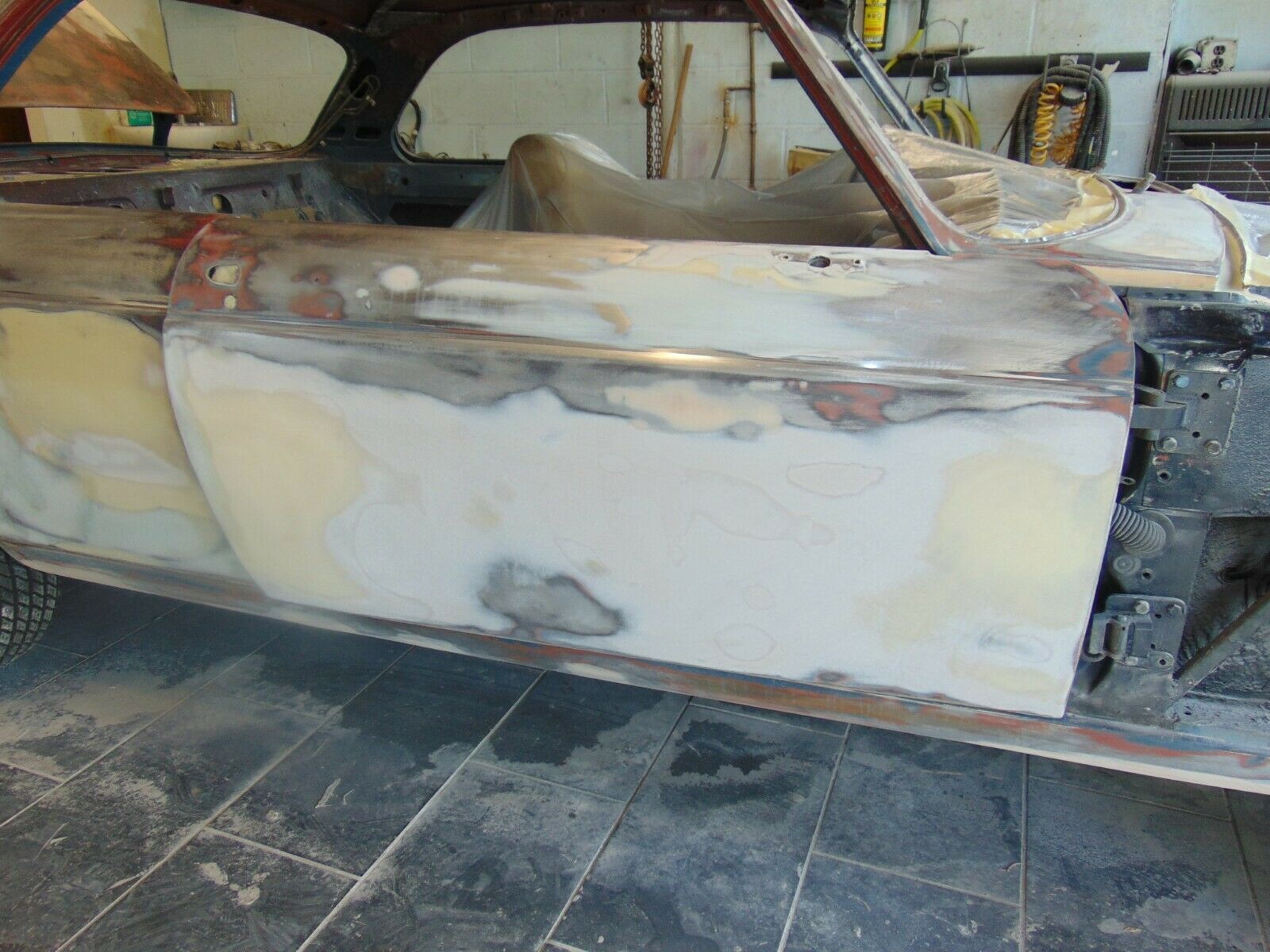

Found a picture from a vehcle in a bodyshop. just above and below the corrugated hose is the two fender bolts.
Thanks Larry for posting the pic of the hinge bolts. I did manage to finish the project this weekend. The lower hinge has now been repaired with a new (used) spring and it works perfectly. Using your technique of accessing the lower hinge bolts via the wing (fender) works well. With the hinge removed and in a vise, and with the help of a friend, I was able to install the replacement spring with a pry bar and a small hammer. It was a little tricky getting it back in and getting the door bolted and aligned, but it's a worthwhile project. Thanks again for your help.
