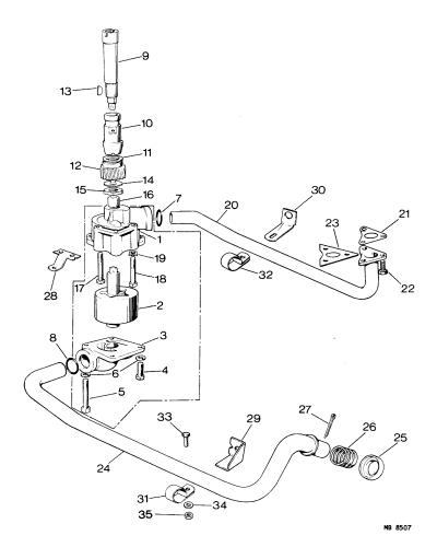

There is a Bronze gear in there that drives the oil pump, and has the slots in it to take the tangs of the distributor drive.

Sump OFF I am afraid. My reasons for saying that are in the following scribbles.

I have attached a drawing of the drive arrangement, and item #9 is the shaft that actually drives the distributor. Item #15 is the nut on the other end, and #16 is the drive coupling for the oil pump.
If it is lifted out via the top, the only way it comes out when rebuilding an engine, it will rotate as the spiral gear comes out of mesh with the crank gear, and the likelyhood of sliding it back in so the oil pump drive #16 actually slides into the "square peg in a square hole" is more a&^e than class.
