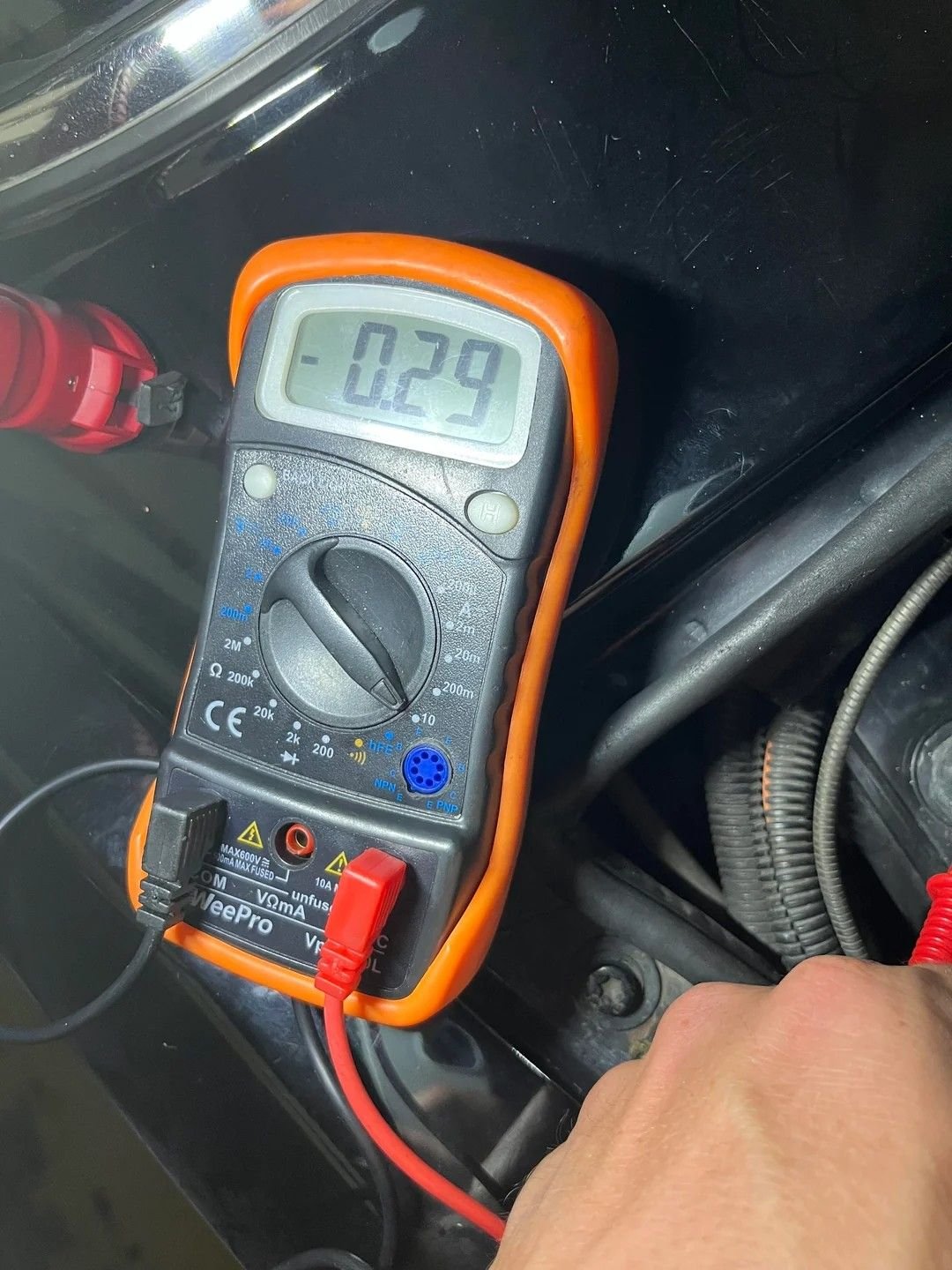

I seem to be pulling 300mA with ignition off (see attached picture, I have the wires reversed so it reads negative). Car is fine if I start every couple days, but battery will be dead if left for a week or so. This is an LS3 swap with aftermarket fuse box.
What I've done so far:
-Double-checked aftermarket wiring to ensure it's downstream of ignition power, and unplugged LS ECU to confirm nothing on the swap side
-Pulled all fuses from primary Jag fuse boxes (driver, passenger, engine bay driver side)
Any ideas on where else to check? I'm pretty new to this type of testing so if something looks off in my picture or description, lemme know!

My series 3 had similar issues twice, first time was trunk light not turning off, second time was the factory trip Computer, both are now disconnected!!!! Something to look into!!
what other modifications have you made? Not asking about electronics? Just curious about your build!!!
So far, so good.
Also pull the inline fuse (or circuit breaker) from the power door lock circuit. This will be somewhere under the RH side fuse box.
Might as well try pulling the inline fuses for the radio, power seat, horn, and cigarette lighters as well
Unplug the alternator
DD

Thanks, guys! A few more things to check. I have unhooked the alternator, but can work through the rest of these items.

Found ~1/2 the issue- previous owner had wired some kind of fan relay that appears to have controlled one of two aftermarket fans, perhaps to speed up engine warming?
In any case, pulling the fuse on that dropped the pull from 290mA to 140mA, so that’s progress.
When I did the engine swap I wired both fans together so they both engage with ignition, so no loss there.
I can poke around more in the future, but that’s great progress!
