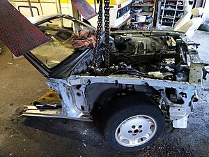

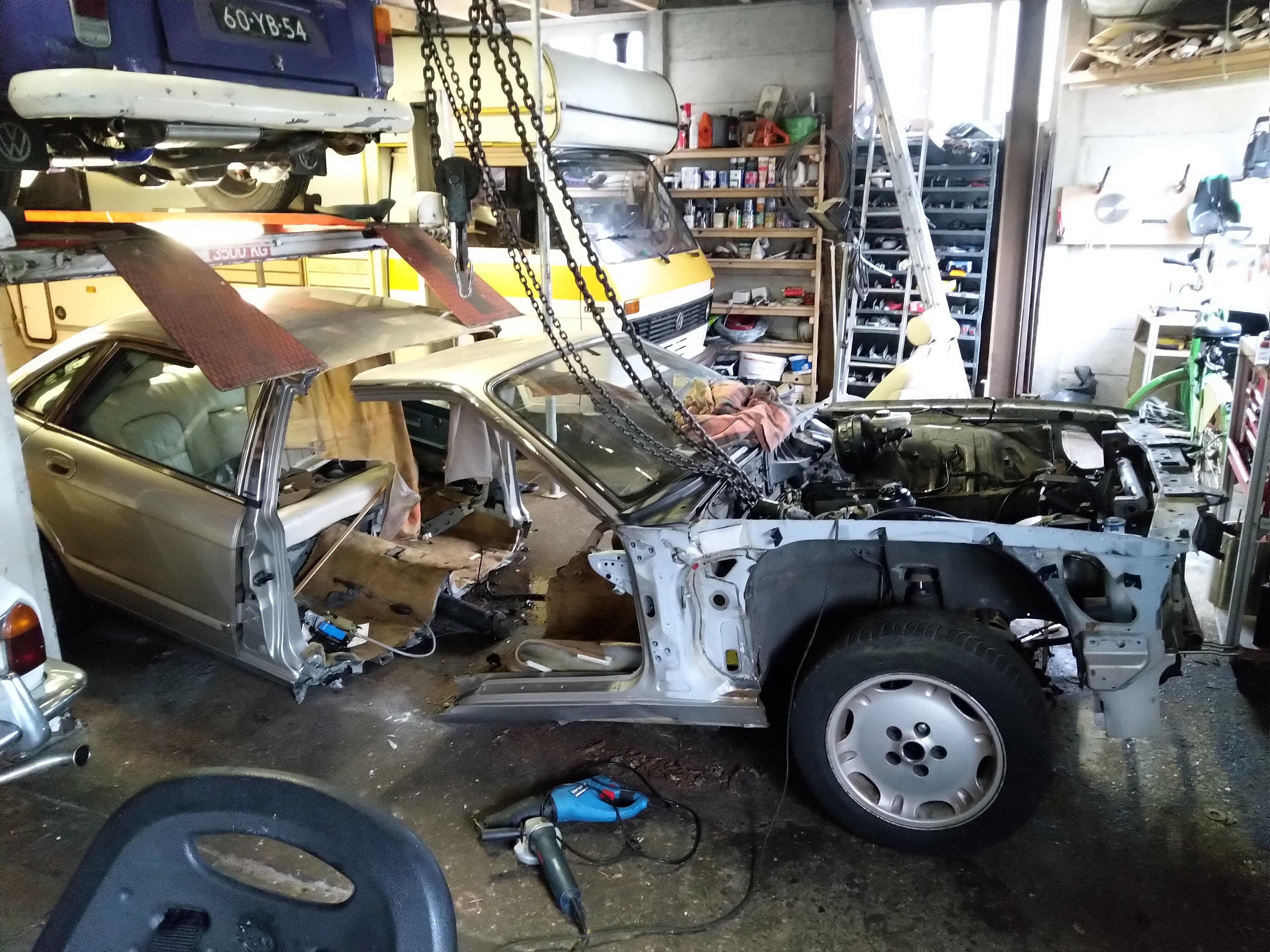

Of course it's less a problem, when the vehicle you want to move, can be split in two parts. and strip it of some heavy stuff. then all of a sudden, my own trailer can do the job..

In the Pacific in WWII, the Seabees did stuff like that. cut needed graders in ahlf for air transport. weld them back together at the field.
