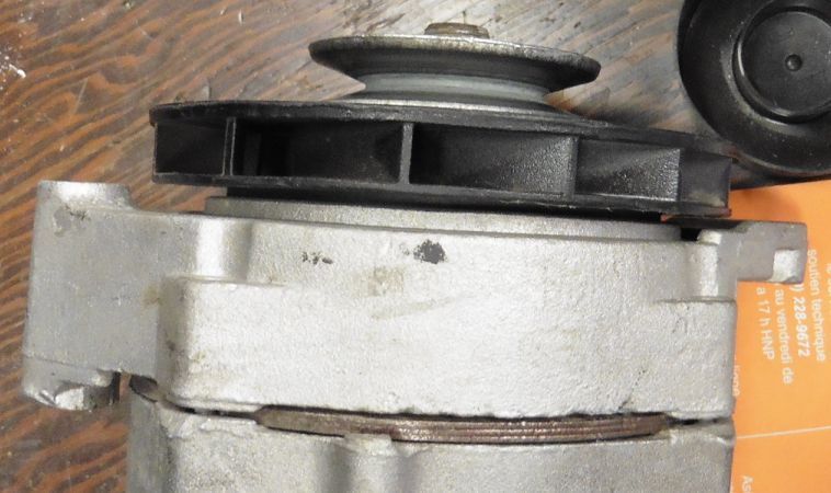

The alternator we stayed around waiting for was a rebuilt from China and was reassembled incorrectly. The cooling fan was installed on the wrong frame so that air, intended to be drawn through the windings, merely went around the fan giving no cooling at all, or at least very little. Husband figured it was good for about a week given the Summer night load (AC and 4 halogen headlights) on the alternator before it had a melt down.
Notice the flat-nosed frame for the high efficiency cooling fan, and a raised ring just behind the fan. There is a corresponding ring on the fan that rides just inside the ring on the frame enhancing the air flow through the windings; a ducted fan as it were.
Below is the "normal" cooling fan, with a conical open frame, and a fan which can pull air from around itself, completely bypassing the windings if it wants to. (Murphy being who he is, it will want to.)
The rebuliders had put the high efficiency fan on the conical frame and sold it as a high efficiency alternator. A quick glance will make it plain why this arrangement won't work, because there's no interference ring (or whatever it's called) so the fan isn't ducted.
Husband was not pleased , and returned the alternator the next day before I could get a picture of it so you'll just have to use your imagination.

Very interesting!!! Corvairs used the AC Delco fan. But, Corvairs use a CCW engine. Any alternator does just fine in CW or CCW!! But, the
bent tin fans as in your second picture are finned accordingly.
Son and I had a "discussion" about that a few months ago. His classic
restified Chris Craft 25 'er is powered by a single ABC. Highly " "enhanced by him. After all, his business was performance engines for a spell. The AC DECO alternator is mounted backwards, so it spins CCW. A tin fan type. I say not good, he says, no issue, still cools??? Only in reverse as intended. So far, it works...
I do recall an accessory for the tin blades. A tin disc to close off the backside and make a fan as in you first picture.
