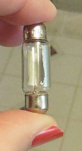

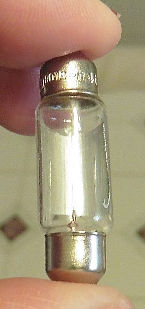

I did replace the map light with an LED and that helped quite a lot, but LEDs in the B-pillar sockets was a disaster! They have a greenish cast by their very nature, and so make the inside the most sickly greenish yellow, makes ya want to gag. And I couldn't get any sufficiently bright anyway.
So, I painted the back side of a couple festoon bulbs with chrome paint, *CAREFUL* to isolate the ends with masking tape as it does have high metal content, just asking for fireworks in the fuse block, and suddenly I have 100% light in the cabin instead of losing half of it to the dark hole inside the pillar.
As these are Incandescents, they do get hot if the door is left open any length of time, resulting in crystallization and shattering of the lenses, which are now Unobtainium. So I installed Jose's door switch disablers (listed on his website), and leave the A-pillar switches disabled, as they're most likely to be left ajar anyway.
I did this nearly 10 years ago and have experienced nothing put Positives.
